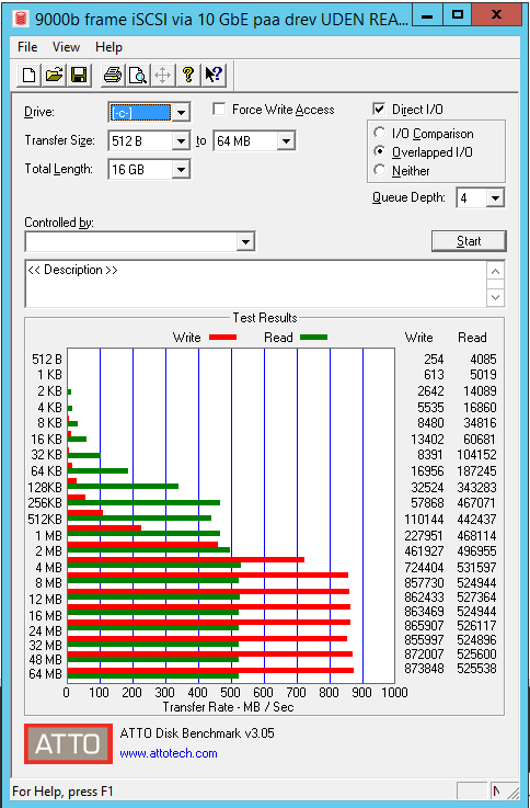

When I run ATTO from within a VMware guest it is able to saturate the 10 GbE iSCSI link when writing (VMware to Starwind). But read is slower and not able to saturate the link (Starwind to VMware).
Only one VMware guest is located on the RAID array to ensure that no outside load is placed on the array during testing.
I believe the bottleneck is on the Starwind server as I've been able to dramatically increase both write and read performance by adjusting the NIC settings profile from "Standard Server" to "Low Latency" on the Starwind server.

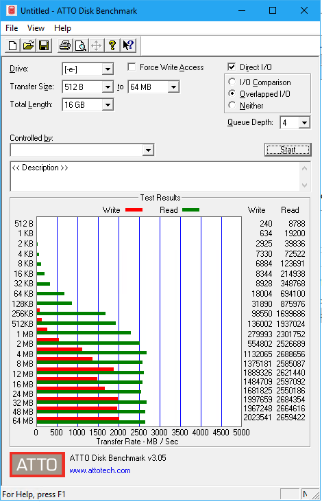

ATTO benchmark directly on the RAID array on the Starwind Server:
local storage.PNG (29.74 KiB) Viewed 83237 times

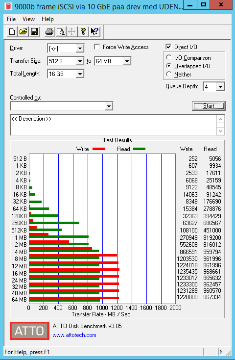

ATTO benchmark from within the VMware guest when using the Low Latency profile on the NIC (best performance I'm able to achieve) - 9K frames:
ATTO benchmark from within the VMware guest when using the Standard Server profile on the NIC - 9K frames:
Note that both read and write are significantly lower here

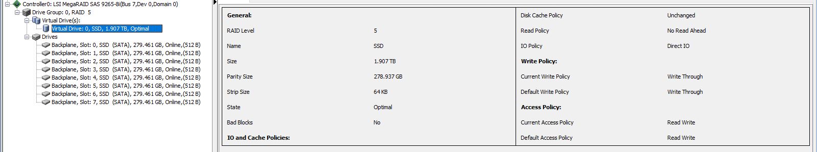

The RAID is made of:
LSI 9265-8i (newest firmware) controller that has 8 x Intel DC S3500 300GB SSD drives directly attached to the controller.
One RAID5 64K stripe size array with all caching disabled. Enabling caching seemingly makes performance worse.
raid config.JPG (73.11 KiB) Viewed 83191 times

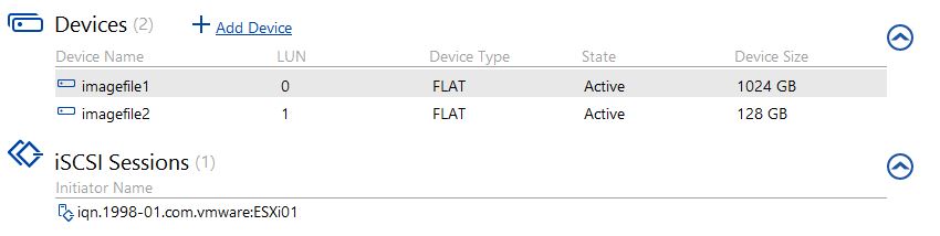

On the Starwind server I have created a thick-provisioned 1TB store with all caching disabled and also created a 128GB store with read caching enabled (1GB in size) for testing purposes.
I have created a VMFS6 datastore on the iSCSI target and moved only a single VM-guest to the datastore which I use for testing.

I stand corrected :) I've managed to get additional performance out of the ESXi host and I now therefore do not believe that the bottleneck is within the Starwind/Microsoft server.
My theory is now that the bottleneck is either in the VMware Software iSCSI Adapter and/or physical NIC related (perhaps improper RSS / Receive Side Scaling) or a combination of the two.
By the way - my testing VM guest OS is a Windows 2012 R2 assigned with 2 vCPUs, 4GB memory, VMXNET3 NIC and the VMware Paravirtual HDD controller. VMware Tools is updated to the latest version.

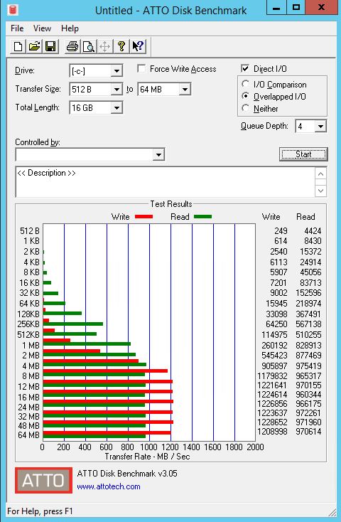

I'm sorry for the late reply. I have tried to make my guest that I use for testing use a thick provisioned VMDK, but the result is the same.
I also tried updating the Starwind software to the newest one available (V8 build 11456 (08 August 2017)), which also did not show any difference.
As of now the performance is "still" the following.
I would really like to track down the culprit of not being able to saturate the VMguest read direction (from starwind to VM guest).
