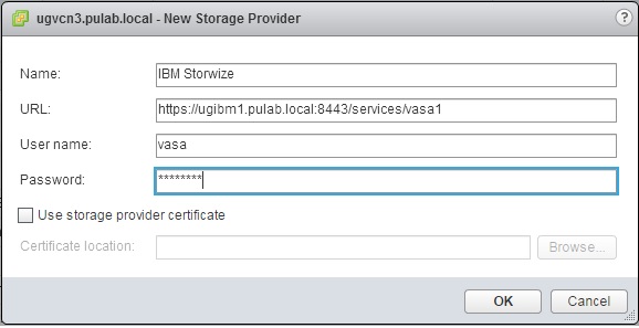

Thanks for the replies but I think something is getting lost in translation somewhere. All major storage systems can be registered inside of vCenter Server so vCenter Server knows how to interact appropriately, with that Storage System. This is done by registering a Storage Provider inside of vCenter Server. (See attached screen shot for more info). "The vendor provider is a software plug-in developed by a third party through the Storage APIs - Storage Awareness. The vendor provider component is typically installed on the storage array side and acts as a server in the vSphere environment. The vCenter Server uses vendor providers to retrieve information about storage topology, capabilities, and status."
Because this is a software based solution, I would assume the storage provider would be installed on the software inside of StarWind ISCSI. I assume they have done this due to them now being listed as a supported platform on vSphere. It doesn't mean they have, I was just hoping they did. Since they have one for the VVol appliance, I was hoping they incorporated it into the StarWind ISCSI.
