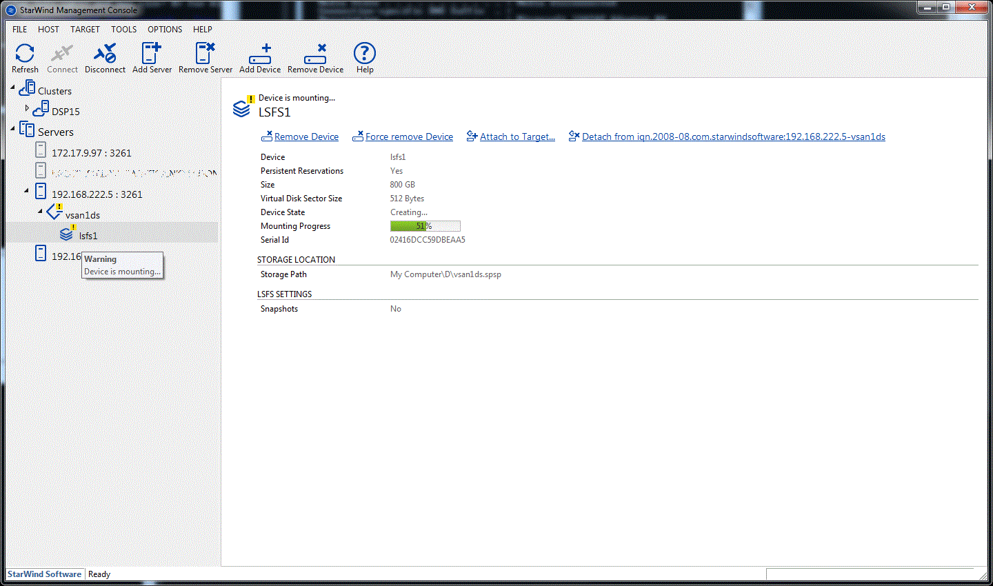

Btw, I saw "Creating..." State (in Managenent Console after restart (single node, no HA)) with progress in "%" ...

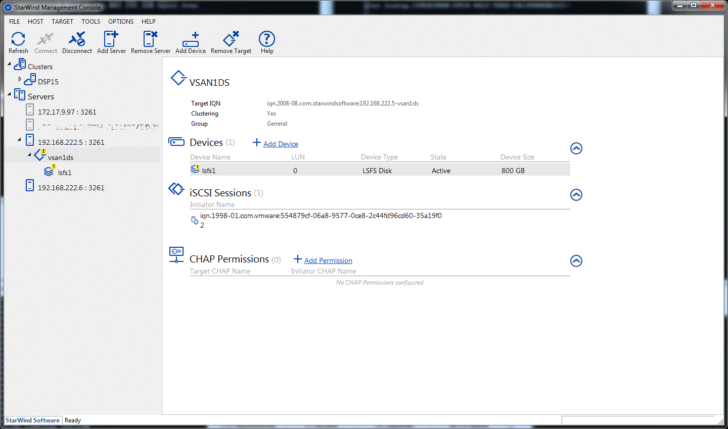

Here is "Target" with "State=Active" Device
But the same time "Device State" is "Creating..." (with "Mounting Progress"="%" and "Warning" presents aslo)
And GetPropertyValue("state") for this Device returns "0" which means "DeviceActive"

Also device mount status can be checked by getting "MountStatus" property:
$device.GetPropertyValue("MountStatus")
list of values for mount status property:
0 - Failed
1 - Created
2 - Creating
3 - Mounting
and mounting percent:
$device.GetPropertyValue("MountProgress")
