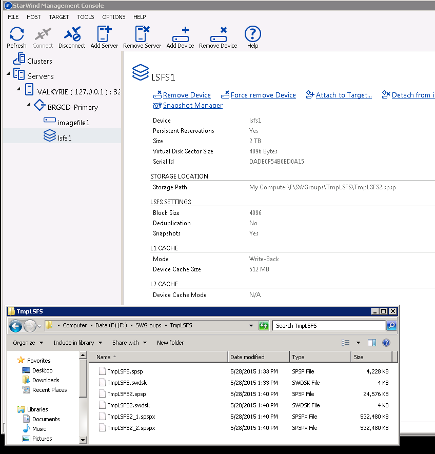

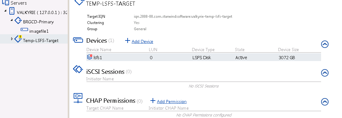

Thu May 28, 2015 8:57 pm
Works
Works

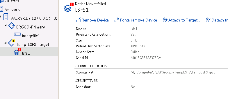

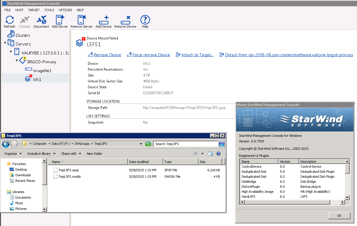

LSFS 2TB.PNG (48.43 KiB) Viewed 52180 times
Does not work
Does not work
LSFS 4TB.PNG (65.08 KiB) Viewed 52180 times
sorry about the delays....
Still having the same problem only able to make LSFS 2TB or smaller, tested on an other server same results. Even with the newest version installed
Where would you like me to send the Log? PM me?

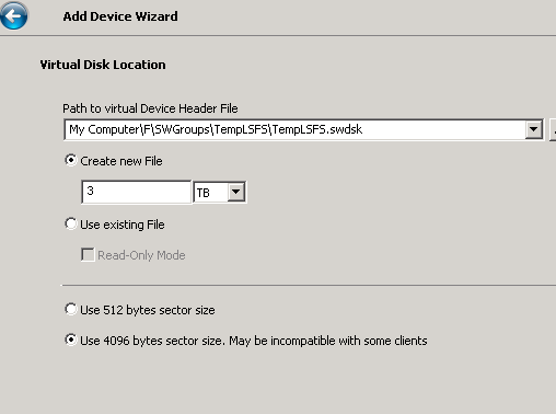

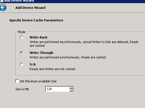

Ironwolf
Posts: 59
Tue Jun 02, 2015 3:24 pm
Good information, however I still don't know what I could be doing wrong, (note 2TB and smaller work)

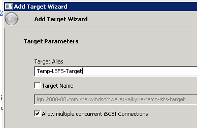

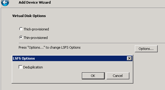

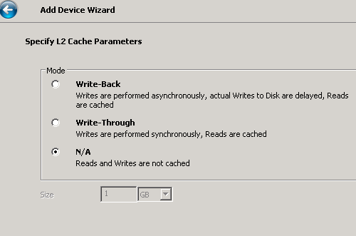

I have attached pictures of key steps
Step 1
Step 1
Step1 create target.PNG (5.7 KiB) Viewed 52162 times
Step 2
Step 2
Step2 size and location.PNG (7.95 KiB) Viewed 52162 times
Step 3
Step 3
Step3 Thin-no Dup.PNG (5.95 KiB) Viewed 52162 times

Ironwolf
Posts: 59
Tue Jun 02, 2015 3:26 pm
a few more
Step 4
Step 4
step4 cache settings.PNG (8.28 KiB) Viewed 52162 times
Step 5
Step 5
step5 no L2.PNG (7.3 KiB) Viewed 52162 times

Did a little more work and discovered it fails at 2727 GB
LSFS boundry found.PNG (26.02 KiB) Viewed 52137 times
