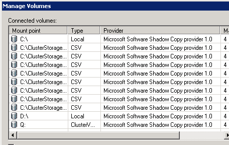

Just upgraded to Build 7354 on:
- Both of my Starwind Hosts
- Both of my Hyper-V hosts (StarWind Hardware VSS Provider)
- My VEEAM backup server (StarWind Hardware VSS Provider)
When I run "VSSADMIN List Providers", it correctly list the StarWind Hardware Provider in the list on all hosts,
But, when I go to run a backup, the backup does not "see" any of my Hyper-V CSV volumes as accessible from the StarWind Hardware VSS Provider, only the Microsoft Software Provider. (See attached screenshot)
My question is regarding my volumes created in v6 before the upgrade to v8. Does the StarWind Hardware VSS Provider only work with new LSFS devices, or should it also work with my older Image-based devices created in v6?
Jeff
VSS Providers.PNG (11.03 KiB) Viewed 33901 times
Yuriy (staff)
Posts: 56
Fri Nov 21, 2014 8:36 am
jhamm,
Every VSS Provider can work only with storage devices that supports snapshots.
In StarWind v6 the only device that supports Snapshots is IBVolume (IBV) device. ImageFile and HA isn't snapshotable in StarWind v6, so they not supported by VSS system.
In StarWind v8 snapshotting supported by LSFS and HA based on LSFS. IBV has limited support in StarWind v8 - old devices still work, but you can't create a new one (we recommend manual migration from IBV to LSFS).
(HA based on ImageFile not supports snapshots because underlying ImageFile not supports snapshots)
Yuriy.
