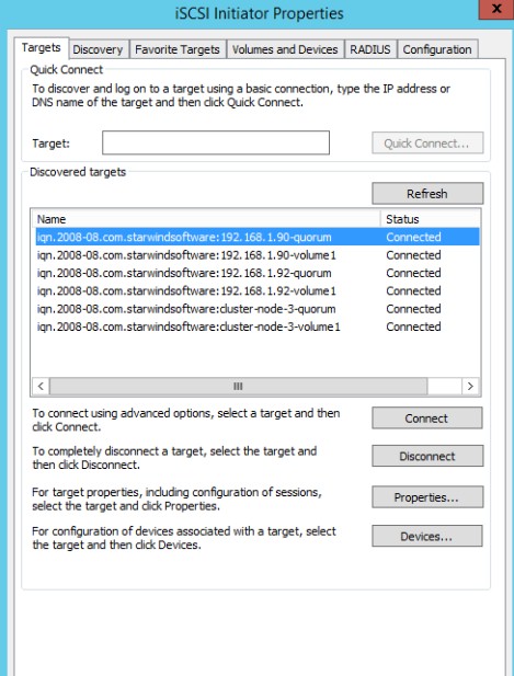

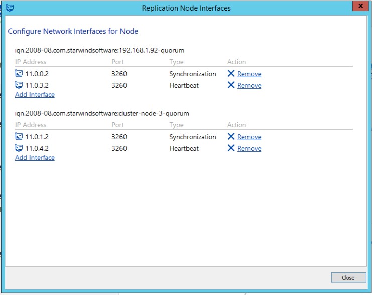

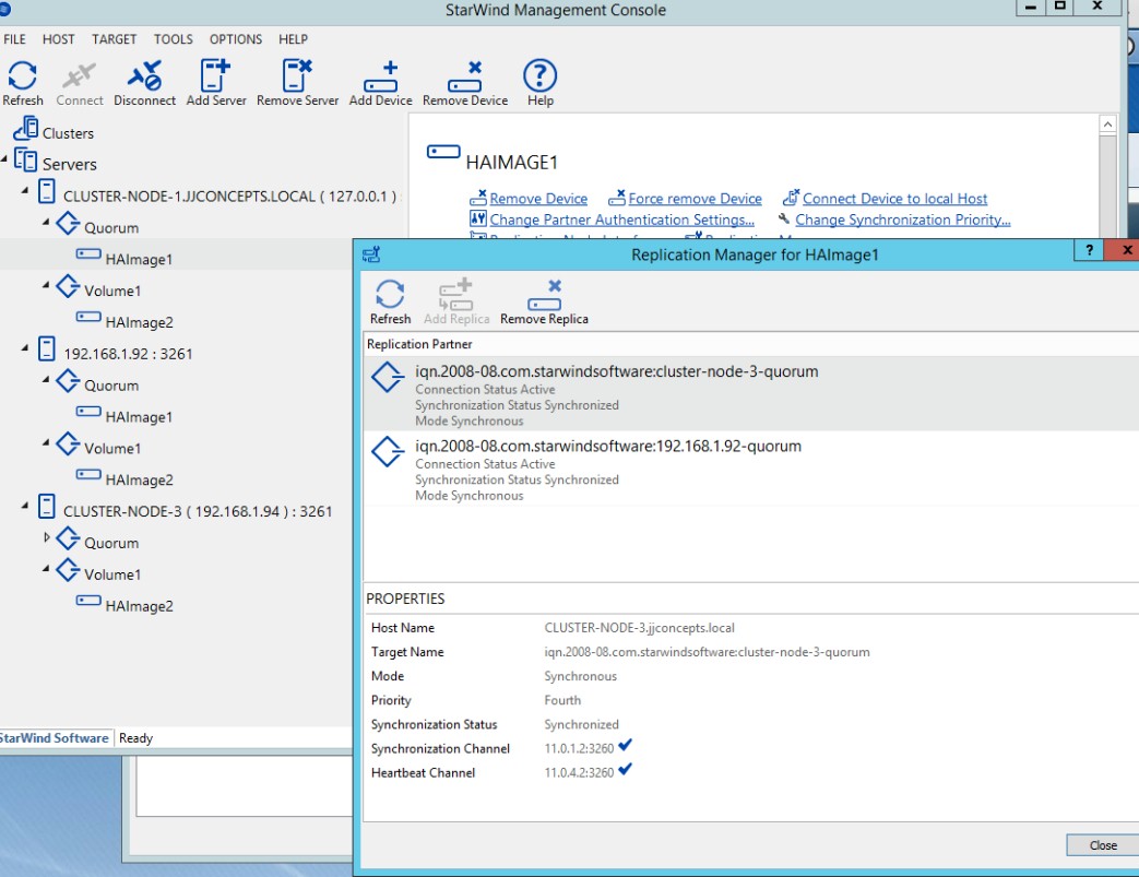

So in true HA fashion each server targets the other two nodes and itself using 127.0.0.1 for the iSCSI on the sync Anatoly set this up and if you need it I could try to do some more screen grabs but basically similar to the iSCSI but through the starwind interface the partner nodes sync. So I have the Quorum and the main disk "Volume 1" So on node 1 the Quorum's partner device is node 2 and 3 for the sync and Volume 1 the same.
So for some reason Starwind labeled my node1 differently, however so you know
Node1 is 192.168.1.90
Node2 is 192.168.1.92
Node3 is 192.168.1.94
as far a split brain no there was not a discussion, but this is what the Quorum is for and the cluster votes.
Here are screenshots from Node 1 showing the connections. I don't see how to add multiple images in the same post so I will post three.
The iSCSI setup
The iSCSI setup

Here are the starwind settings one of 2

Here is two of two
Hope this helps. - Jason

It seems Jason shed some light on your misunderstanding of Starwind HA concept, Slingshotz. Thank you, Jason.
And about split brain: it is possible only if sync channel and HB are dead simultaneously.
