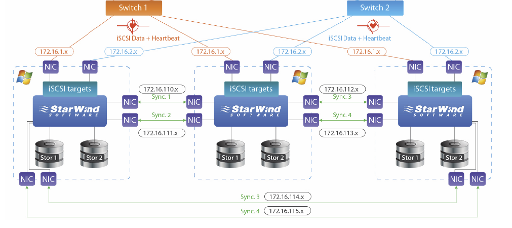

Also one more question on LAN/NIC configuration, as the diagrams currently available don't show a 3-node Hyper-v Native-SAN arrangement and best practice. Attached is the best diagram I have that Anatoly sent me last month.
I plan on having 2 x Dual 10GBE NICs per server + 1 x Quad 1GBE NIC.
Sync channels will be direct connected to each others 10GBE NICs with no switches as per attached diagram as Sync 1,2,3 & 4.
Will it suffice to use two of the 1GBE ports on each server as the iSCSI/Heartbeat traffic?
If I am only providing iSCSI targets to the other 2 nodes, is it ok to direct connect those 1GBE iSCSI/Heartbeat channels to each other and not use a switch?
Should I add a third 10GBE card and use it for iSCSI/Heartbeat traffic? Current SAN is seeing around 2500 IOPS 95th percentile loads with current 30 Hyper-V guest environment.
Just wanting to be 100% on the best practice configuration before pulling the trigger so to speak.
It will be enough for propper funtioning of the HA device(-es). But basically HeartBeat is low resource consuming technology (it uses ~200MB per month), but it helps to avoid the split brain issue, so it is highly recomended to have HB on each data link (except SyncChannel, which is already comes with HB functionality)
That should work :)
As I`ve mentioned above - HB is low resourse consuming, so you just need to keep your system ballanced. Please refer to the Networking section of our Best Practices documentation.
