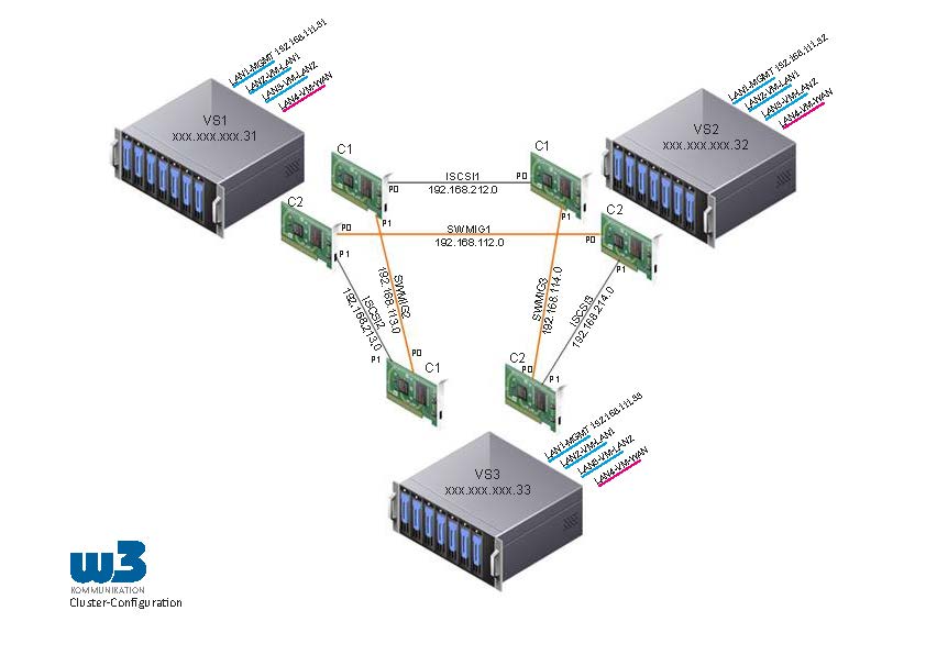

After setting up a two node cluster (working fine) I added a third node, equally configured, but when I try to mount the ISCSI targets I just see the scsi, not the mpio target.
This only happens on the third node (vs3), MPIO is configured here but not visible in the targets,
thx for any help,
Ralf
Cluster-Config
Cluster-Config

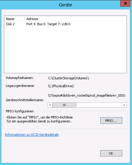

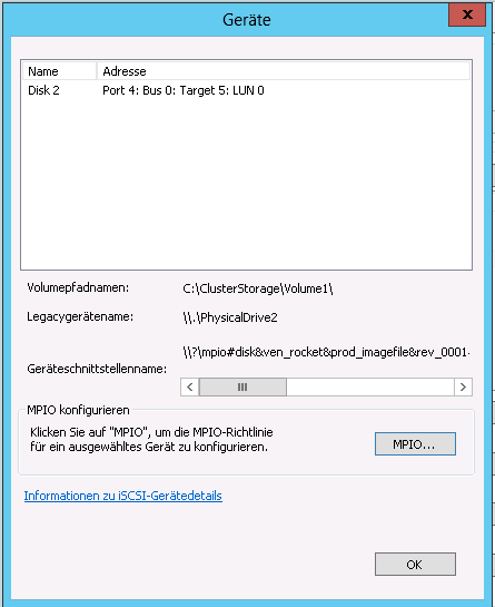

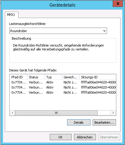

yes all paths are connected, e.g. on vs1 connection to itself, to vs2 and to vs3 (firstnode, secondnode and thirdnode). Same on vs2 (connections to vs1 and vs3).
But on vs3 the connections don't show up as mpio paths but as singe scsi (iscsi) volumes, see attached images.
VS1 all mpio paths of CSV (itself and to vs2 and vs3)
VS1->VS3
VS1->VS3
VS1->VS2
VS1->VS2

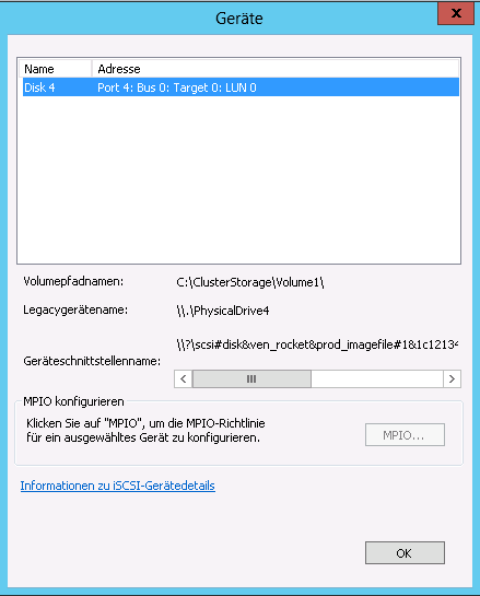

and here vs3 showing only scsi target no mpio target
vs3 to vs1 (or to itself) not showing the MPIO

solved :-)
thx to Max! I simply forgot to enable MPIO in
MPIOcpl ->second tab-> add support for iSCSI devices
Ralf.
