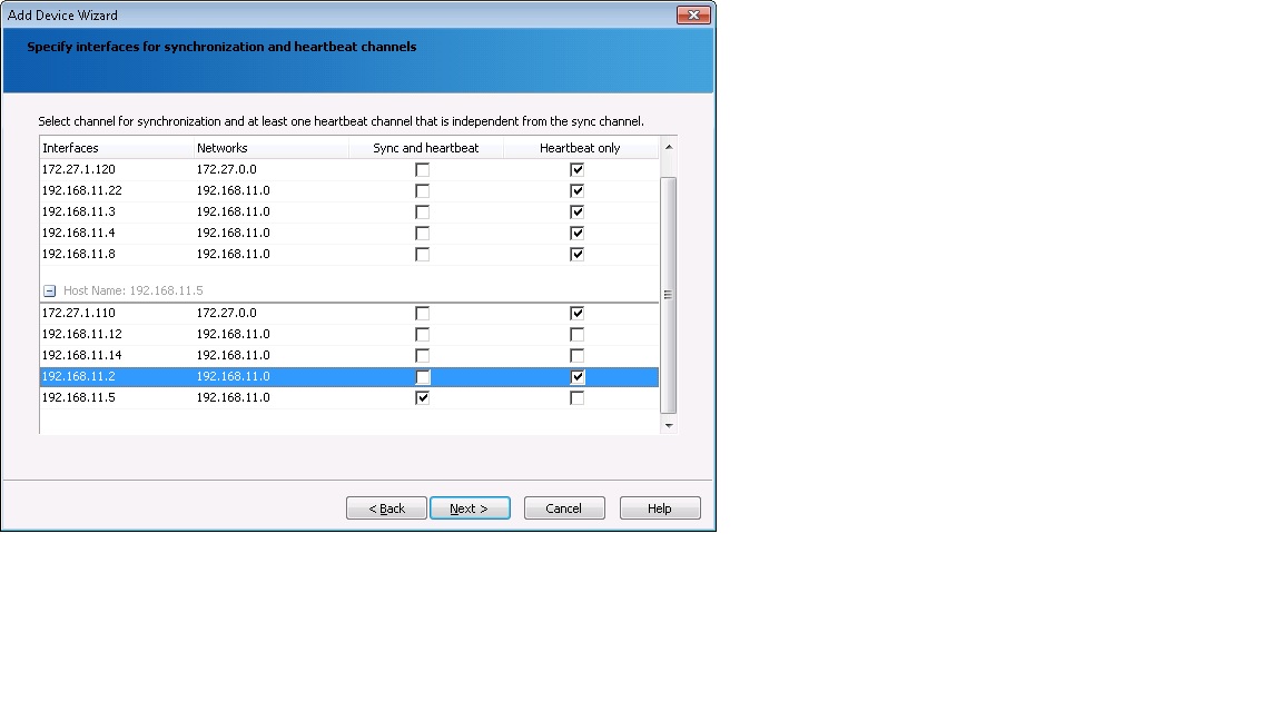

Since you ask though, I went to create a new disk img today and am slightly confused at what is going on. I stepped through the steps for an HA device and I am now at the point of specifying interfaces for Sync and HB. I've attached a screen shot of what I am doing to help make things cleared. I would expect to be able to check the boxes individually, but I can't. IF I click one all of them move. So I can't specify which is my HB and which is the sync. All of the 192 address are direct connect, no switch. The 172 is the corporate network interface. It's almost like it won't allow it on the same network even though they aren't on a switch. I don't remember this being a problem on 5.8
Wed Feb 20, 2013 12:43 pm
Yeah, its new. This question is well explained here: http://www.starwindsoftware.com/starwind-faq#q_22

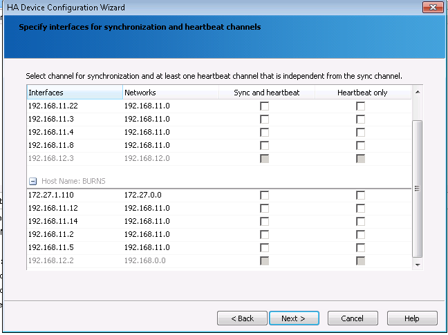

Ok, so following the steps there to change HB, I dropped one of the HA images on the partner. Both HA nodes have another NIC plugged into eachother that is in the 192.168.12.x. I go to replication manager, walk through the steps and get stuck at the choosing interfaces. My new 192.168.12.x choices are greyed out. They can ping each other fine, why would they be greyed out?
Mon Feb 25, 2013 12:57 pm
May I ask you to give us the screenshots please?
mooseracing
Posts: 91
Joined: Mon Oct 11, 2010 11:55 am
Mon Feb 25, 2013 4:21 pm
Here is the interface list. Also it doesn't matter which host IP I choose when setting this up, they stay greyed out.
Wed Feb 27, 2013 4:35 pm
It looks like the network was not picked up on the second host. Can I ask you to open the SW Mgmt console, connect to host, goto Configuration->Network, take the screenshot and provide it to us?

Double check netmask in windows ip settings box
