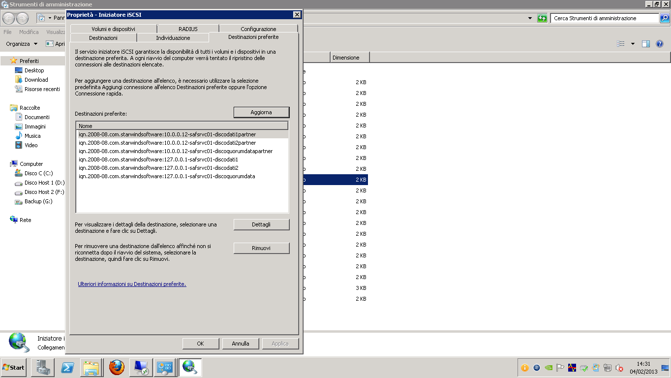

1. Not sure exactly, but can you post pictures of the isci Initiator Properties the targets tabs on both Hyper-V machines in the cluster.

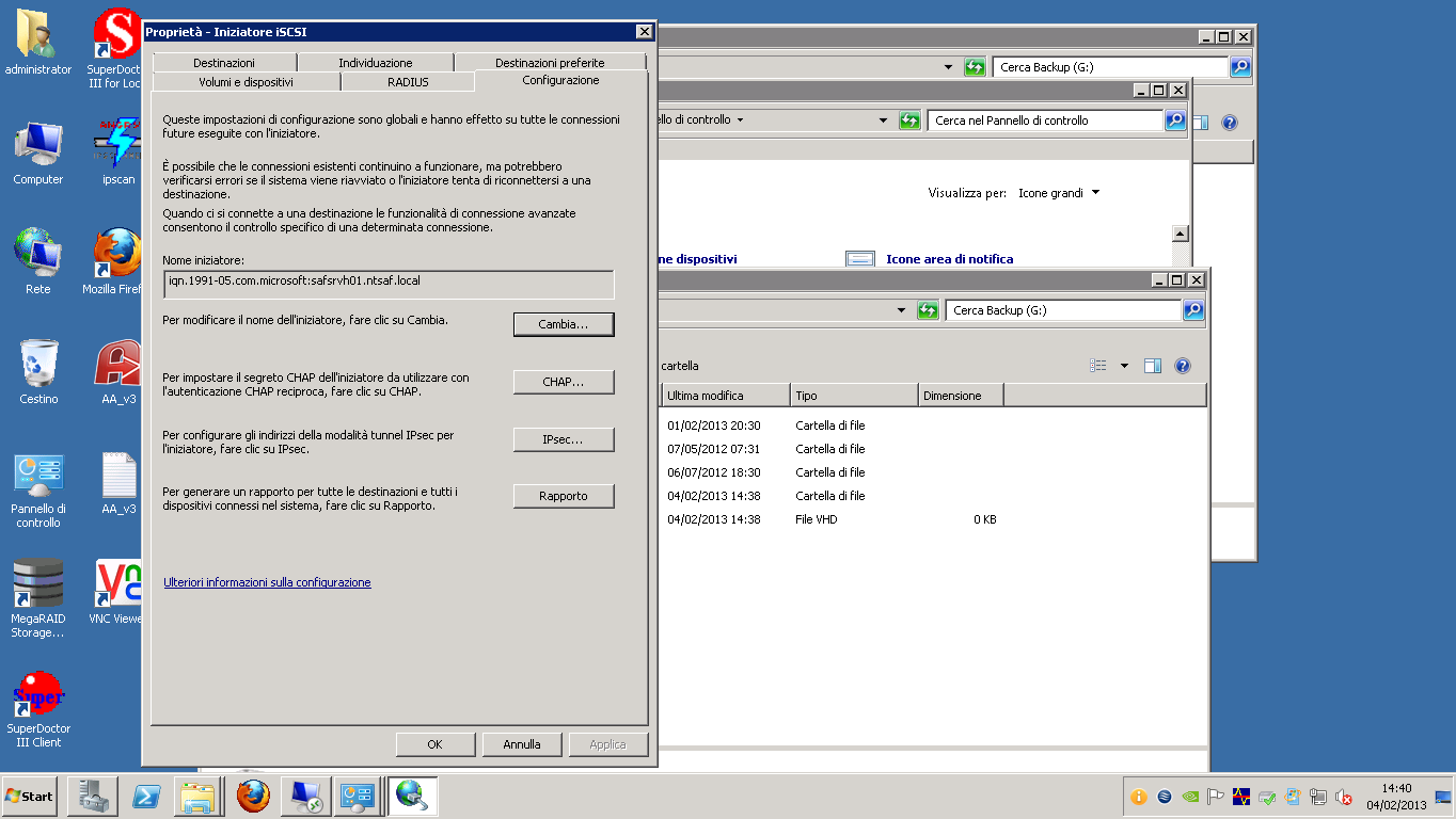

Add Photo form ISCSI Microsoft and ISCSI of Starwind.
in the follow message i attach this image
ISCSI - Configurazione - SERVER 01.png (92.5 KiB) Viewed 23636 times

second image - ISCI Targets
ISCSI - DESTINATANAZIONI PREDEFINITE - SERVER 01.png (71.38 KiB) Viewed 23636 times

ISCSI - main propriety
ISCSI - MAIN - SERVER 01.png (73.52 KiB) Viewed 23639 times

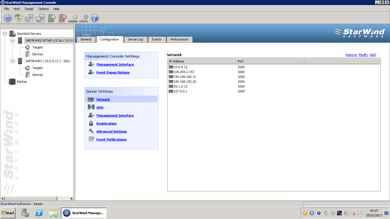

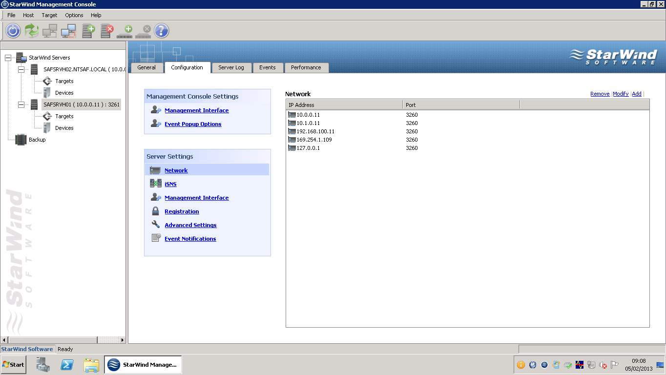

I also see many IP address in Starwind incorrect, i must delete or wath can i do?
Is Correct?
I only use 192.168.100.x, 10.0.0.x, 10.1.0.x
Attach Server 1 starwind LAN config image
Starwind - Server1 Network.png (76.28 KiB) Viewed 23629 times
lonewolf74
Posts: 12
Joined: Thu Jan 31, 2013 8:03 am
Tue Feb 05, 2013 9:23 am
Attach Server 2 starwind LAN config image
Starwind - Server2 Network.png (75.82 KiB) Viewed 23632 times
Max (staff)
Posts: 533
Wed Feb 06, 2013 1:09 pm
Hi Lonewolf74,
Seems like the HA devices are connected properly.
The networks you see in the StarWind management console are those StarWind has discovered as usable.
You can restrict use of certain networks by disabling them.

Thank you very much for the pictures. On the Destinazioni tab can you scroll over to show the Status, and I would need to see that for All Hyper-V hosts in the cluster.
