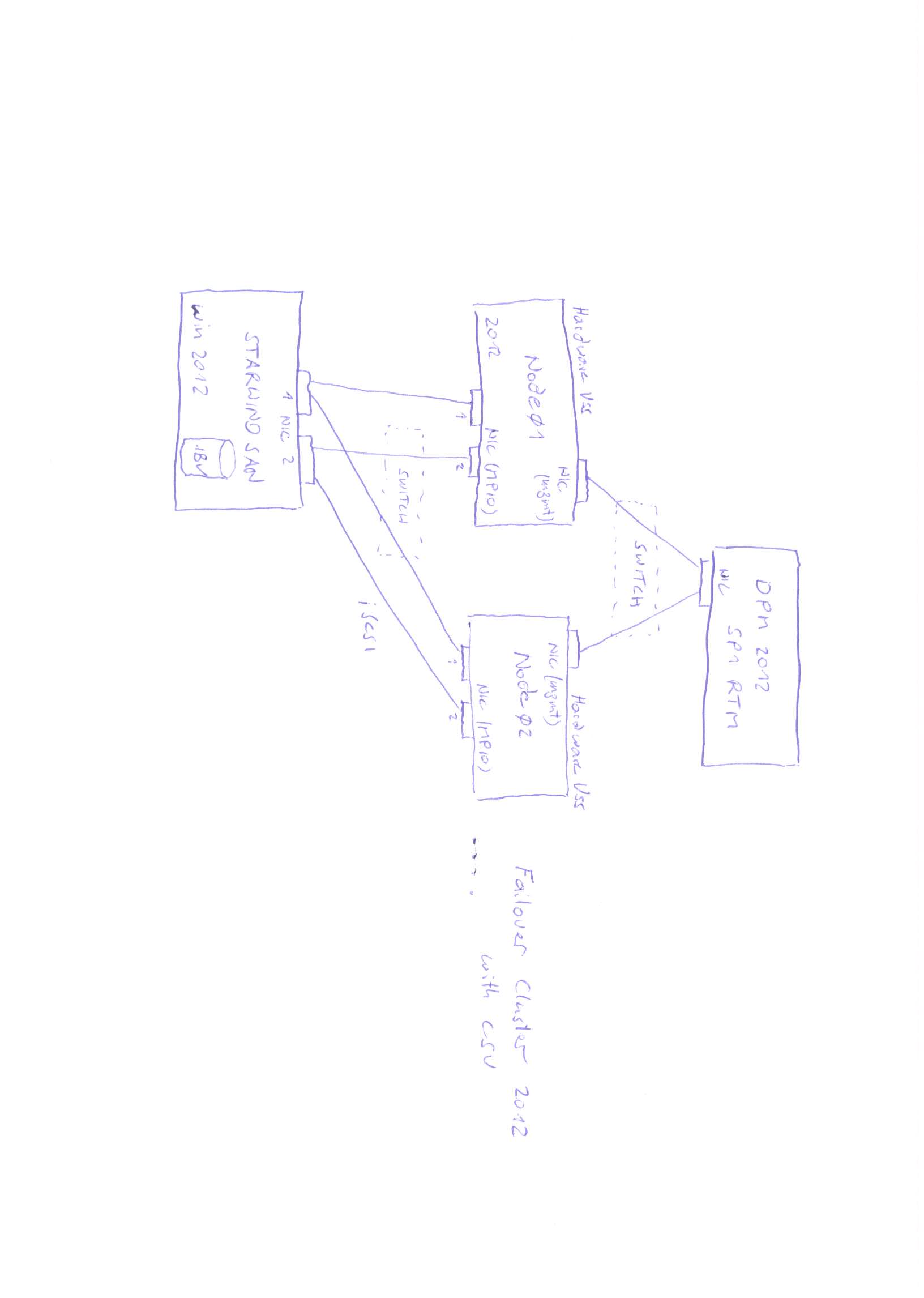

Tue Jan 15, 2013 2:08 pm
Is it possible for you to provide us with the detailed diagram?
We still dont see where starwind is running, how does it connected, how everything is connected, etc. I`l appreciate if your diagram will be as detailed as possible, so as the description of actions that I`m requesting again.
Thank you
pit
Posts: 11
Joined: Wed Dec 19, 2012 10:21 am
Wed Jan 16, 2013 9:59 am
Hi!
I've attached the (simplified) schema. It's all recommended standard config.
