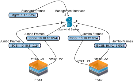

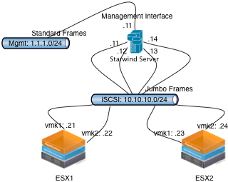

Which option from the two diagrams below?
Option # 1:
Option # 1.png (36.73 KiB) Viewed 12598 times
Option # 2:
Option # 2.png (48.89 KiB) Viewed 12591 times
@ziz (staff)
Posts: 57
Joined: Wed Aug 18, 2010 3:44 pm
Fri Oct 28, 2011 8:43 am
Option 2 will be better.
