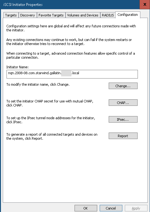

I changed the Initiator name to 'nqn' in the 'Configuration' Tab.
In ONTAP, it would not accept the nqn that windows was using, so it had to be
nqn.2008-08.com.starwind:gallatin.domain.local
vs. windows that would not discover the target unless it was set to
nqn.2008-08.com.starwind.gallatin.domain.local

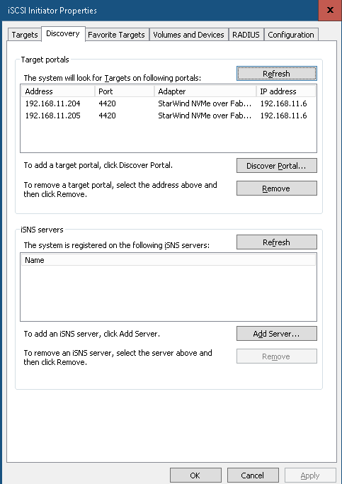

I added the two Target Portals successfully 192.168.11.204:4420 and 192.168.11.205:4420 using the iSCSI initiator properties tool.

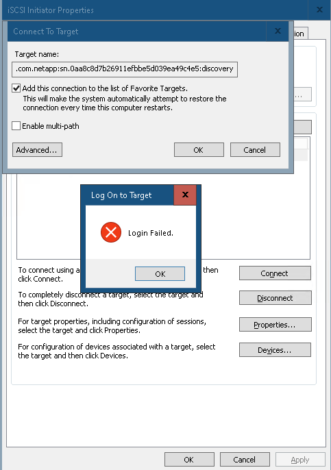

When I click the 'Targets' Tab I see the Discovered Targets and status is inactive. The target name is:
"tcp:nqn.1992-08.com.netapp:sn.0aa8c8d7b26911efbbe5d039ea49c4e5:discovery"
When I attempt to connect To Target, I get the following error: 'Log On to Target: "Login Failed". I've tried specifying the Advanced settings, including the 'Local adpater as 'StarWind NVMe over Fabrics Storage Controller' and the 'Initiator IP:'as the dedicated VLAN11 adapter and the Target portal IP: as the 192.168.11.204/8009

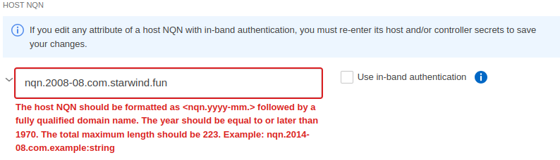

Maybe this is the problem - When adding the NQN to NetApp, ONTAP9 does not like the formatting that the Starwind Initiator is using and is requesting a :STRING at the end. Is there a way to modify the StarWind Initiator HostNQN?

Thanks for your reply. Yes, please try a different NQN for StarWind.

How do I change the NQN on the Starwind Initiator?
EDIT: I changed the host NQN by adding the HostNQN at the end of my insert command:
StarNVMeoF_Ctrl.exe insert_all_tcp 192.168.11.204:4420 192.168.11.33 nqn.2008-08.com.starwind.fun:7767463
I then added this to ONTAP9 and it connected successfully.
