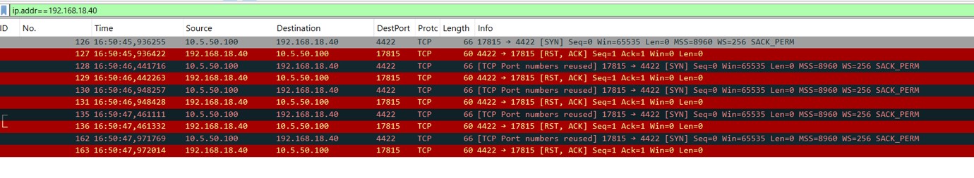

I am trying to setup a connection between my TrueNas system and my windows11 Pro PC using TCP as protocol.
It does not work. Using Wireshark I see that the NVME-oF initiator sends a TCP package to the TrueNas server, whci answers with an ACK. For unkown reason the ACK is not accepted and the NVME-oF initiator starts a new session using the same ports. That message is again answered with an ACK and that sequence repeats four times.
Up to the next refresh when it all starts over.
However no real communication and no discovered targets

Can you please attach the Wireshark log?
Make sure
-drivers are up-to-date
-firewalls are opened.
-FW is up-to-date.
-Initiator nqn is allowed on the Target side.
Also, does RDMA connectivity work?

Here some info:
I start with the command line version output
TCP
PS C:\WINDOWS\system32> StarNVMeoF_Ctrl.exe discovery_tcp 192.168.18.40:4422 10.5.50.100
StarNVMeoF Controller Application v 2.0.0.702
Our Miniport #4 (ver 2.0.702, lic:1)
Discovering of TCP addr 192.168.18.40:4422 from 10.5.50.100...
NET_LUID: 0x600801A000000
STAR_NVMEOF_IOCTL_DISCOVERY request failed (err 0, status 0xc0000236)!
PS C:\WINDOWS\system32> StarNVMeoF_Ctrl.exe discovery 172.16.10.10:4420 172.16.10.100
RDMA
- I do not think it can work RoCE(v2) is not active on my Connext-4 LX
- e.g. because it is not support on TrueNas community edition which by the way is using the same Connect-4 LX
Discovering of RDMA addr 172.16.10.10:4420 from 172.16.10.100...
STAR_NVMEOF_IOCTL_DISCOVERY request failed (err 0, status 0xc0000034)!
Driver: The windows Connect-4 LX cards are use driver version 3.10.25798.0 which is the latest possible I think
Firewall: pfSense has been opened and I think that is OK given the fact that there is basis TCP-communication between PC and NAS
Firewall: pfSense is running the very latest pFSense+ edition
Network: the elements are interconnected via VLANs one towards the PC which is not aware of that)
and a trunk with another vlan towards TrueNas
The switch is a Mikrotik CRS317
I am using jumbo frames: 9014 for the PC, 9216 for the FW-trunk and the NAS-trunk and 9000 for the pfSense and NAS vlans
Initiator nqn: At this moment all host are allowed
RDMA: does not work as explained above
As requested
Louis
Note I have problems adding a capture I tried to add one inside a zip and one with a jpg extension. Can not drop and place as well get http error. Whatever IO hope it worked

To me, it looks like something is wrong on the networking side.
Please try completely disabling the firewall.
Is there any way to connect the NAS directly to the Initiator host? does ping -f -l 8000 go well? Try setting MTU to 1514. 9014 can be fragmented; 9216 are likely to be fragmented. Yes, it is still often a problem.
Also, are you using a trial or free? Run С:\Program Files\StarWind Software\StarNVMeoF>StarNVMfInitiatorService.exe --checklicense
Please also try this version https://starwind.my.salesforce.com/sfc/ ... 20HsG.mD7Q
