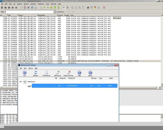

We just found this... If is data storage CORAID connected to Server and on this server is running AoE initiator and after this situation is disconnected patch cord than AoE Initiator stopped sending packets(network adapter is down/disconnected). After reconnect patch cord, AoE Initiator resend all packets which wasn`t delivery and after this server is connected to data storage.
If is switch between data storage and server, and connection is lost between CORAID and switch, than AoE Initiator resend data witch wasn`t delivery and if AoE Initiator don`t received "answer" AoE Initiator is going to "failed". After reconnected communication, AoE Initiator doesn`t send packets and for this reason connection can not be restore. This situation we can see in logs from wireshark see annex. How should work reconnect in AoE Initiator after failed?
Can you tell me how important are ARP`s packets in this case which only forwarding MAC address to IP? AoE`s protocol working only on L2 MAC`s address. Switch is set by default. If the bag in setting of switch, AoE Initiator try reconnecting (which should be in Wireshark) and switch should have problems with this packets. But its not true – after AoE intiator went „failed“, AoE Initiator dont sending any data for reconnecting. Can you send me, how is working connect and reconnect in application AoE Initiator?
