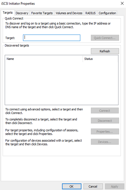

Tape does not show discovered targets after adding discover target portal on iscsi client.

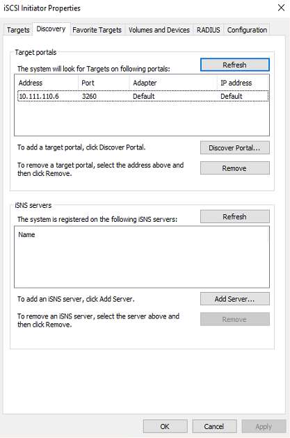

Could you please show discover target portal screenshot?

Please see discover target portal screenshot
