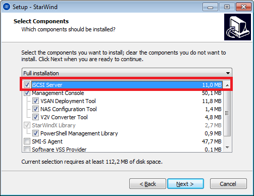

Three steps to add the device:

Posted: Wed Jun 04, 2014 6:47 am
by Bohdan (staff)
Also make sure that 3260 and 3261 tcp ports are free on that machine.
You can check it launching cmd.exe and running "netstat -abn" command.
Re: Tape redirector
Posted: Wed Jun 04, 2014 9:42 am
by anton (staff)
This is our problem and not yours :( If you run unsupported version of OS (Windows Server 2003 or Windows XP) you're not going to see "Service" in the list of available options. Please confirm what you have and we'll figure out how to tell to customer "this option is N/A" instead of just hiding it. Thank you!
