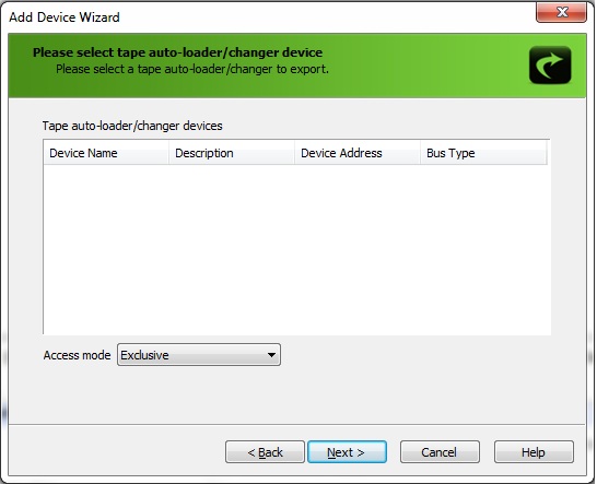

When I select the option to export changer nothing is displayed. I only get an option when selecting expport tape drrive. How doi locate the logs?

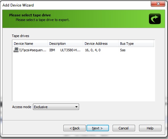

Please see attached screenshots as requested. Thanks in advance for helping.
I can see the tape drive for export.

tape drive export.jpg (45 KiB) Viewed 25333 times
I cannot see the auto-loader/changer for export.
tape auto-loader-changer export.jpg (42.83 KiB) Viewed 25333 times

Can you confirm that you have installed all the tape drivers on the machine where the Tape Redirector installed?
About your question: you can find the logs in the corresponding folder in the software installation folder.

We had the same problem with Dell PowerVault 124T Autoloader in Dell PowerEdge server with Windows 2003 Server.
All you have to do is to stop Removable Storage service and autoloader will show in StarWind management console.

Thank you for the hint, TomazicM. kyar600, I think it worth a try.
