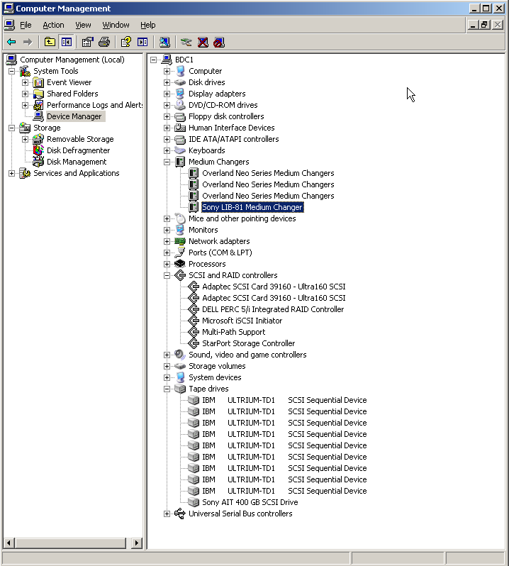

Could be enumeration issue. What symbolic link name do you have for your loader/changer? Can you provide StarWind log for scan attempt and also a screenshot of your Device Management tree with loader-related items expanded? Thanks!
jmcclellan
Posts: 17
Joined: Wed Feb 29, 2012 5:22 pm
Thu May 03, 2012 5:57 pm
sorry for the delay, apparantly I missed subscribing to the topic :)
I suppose the symbolic link name is the device instance id in device manager. for the changer in question that is;
SCSI\CHANGER&VEN_SONY&PROD_LIB-81&REV_01MB\6&2859947C&0&000
screenshot attached.

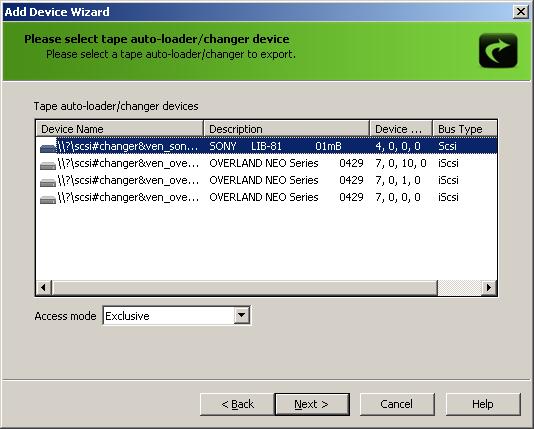

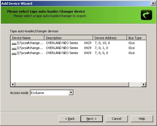

sorry if perhaps I just don't understand what you are asking for. I just posted screenshots of how the changer is displayed on the starwind machine didn't I? and I can't have anything 'connected to' the starwind machine because starwind, which is installed on the machine with the changer physically attached, doesn't even recognize the changer to export it for connection by others. there is nothing connected to starwind at this time because there is nothing to connect to. this is the whole problem.
maybe this what you want? this is the export autoloader screen from starwind. it simply lists the 3 other devices on the system, and not the one we are talking about. if not please clarify what you need and I will try to provide it.

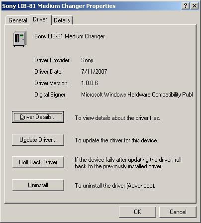

and the driver installed for this changer is shown below. but again this is installed on the local machine that the changer is physically connected to, which is the machine starwind is installed on. not a remote machine connected to starwind.
this machine and changer/drive have been used as-is for a long time without issue using backup exec. it is direct attached via scsi. the other 3 'Overland NEO' devices shown are iSCSI connected to a VTL.

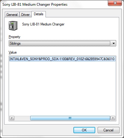

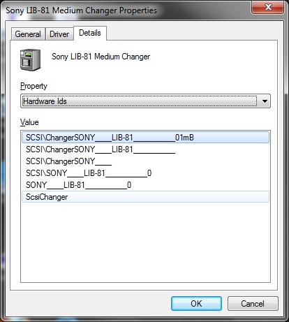

Can you please provide us with the screenshot of the Details tab in LIB-81 media changer properties? We need to see Device ID property and Siblings.
Thank you
jmcclellan
Posts: 17
Wed May 16, 2012 5:44 pm
there is no Device ID property available in the details. Hardware ID perhaps for this one? hardware id and siblings attached. the siblings value is too wide for the dialog box, the complete value is SCSI\SEQUENTIAL&VEN_SONY&PROD_SDX-1100&REV_0102\6&2859947C&0&010

well I feel kinda dumb now, that was it. as soon as I stopped the Backup Exec services, the changer now shows up on the list of devices for export.
I didn't even think of this, because the drive IN the changer was appearing for export, as were the the 3 other changer devices (albeit these are iSCSI). I supposed Backup Exec must hold the physical changer in some sort of different state?
might be nice if it were possible to list, but have it identified as locked or something.
thanks alot for your help on this! much appreciated.

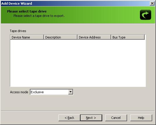

sigh. so when I get to the next page in the add device wizard after selecting the auto-loader/changer device, it says please select tape drive. and there are no tape drives on the list. however the drive within the library shows up on the export tape drive list. what to do here now!
Thu May 24, 2012 11:34 am
Can you please provide us with corresponding two screenshots and the logs on the time of the issue (I will ask you to specify the time also)?

Tue May 29, 2012 7:16 pm
ok here it is

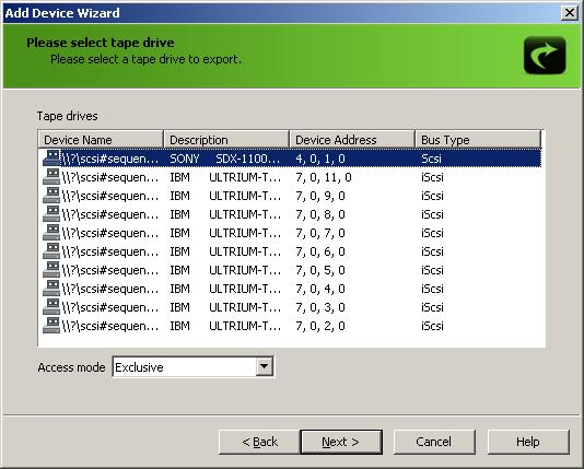

if I export tape drive, the SDX-1100 drive contained within the tape library is listed;
if I export autoloader, the LIB-81library is listed;
and in the next step where it asks to select tape drive, there is nothing listed. I would expect the SDX-1100 here?
