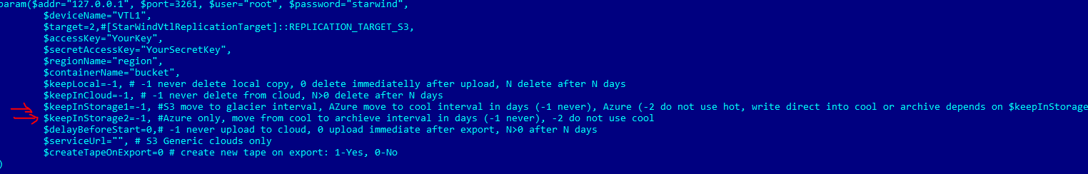

Set $keepInStorage value for both to -2.
script
script
