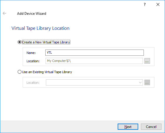

3. The guide provided above highlights how to set up StarWind VTL. To add an existing tape library, specify the path in the Add Device wizard.

Here is the picture from the step 3.
How to add Existing VTL.png (13.39 KiB) Viewed 126787 times
