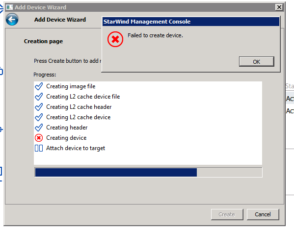

If the partition that the LSFS files sit on is greater than 2TB, only 64k block sizes can be used (all other sizes fail), regardless of the size of the Virtual drive weather 1GB or 500GB; anything but a 64k block size will fail. I initially thought this was related to the cluster sizes used on the NTFS partition the files sit on, but this doesn’t seem to be the case, as I had used 64k, it is more directly related to partition size.
If I create a partition of 2TB or smaller, that the LSFS files will sit on then 4k blocks sizes will work.
L2 Cache also fails if a block size is larger than 4k in the virtual drive.
This makes the drive management a bit hectic to enable LSFS and L2 Caching. I would now need to layer partitions of a large raid 60 into small 2TB chunks.
Also I noticed that LSFS suffers from the same problem DeDup LUNs did, it will only use one CPU Core for the entire processing load. Will this be changed in the future so that different LSFS LUNs will use different cores? As it is now, I can saturate a single CPU core, and only reach about 2 gigabits throughput with the raid 60 nearly idle, and the remaining CPU cores idle.

I just confirmed it... LSFS Thin, 4k can only be used with 2TB or less partitions, and...
it seems the other sizes 8k,16k,32k... are dependent on the underlining NTFS cluster sizes
The drive that I had formatted with NTFS at 64k Clusters was reformatted with 16k, and now I can use 16k and up, but I can not use 4k or 8k. My only reason to use smaller size, I was trying to use the L2 Cache, thinking it required 4k or something as none of the parameters for the L2 Cache are settable, I have yet to get a single virtual drive to work with it, regardless of the parameters or locations I use
Alex (staff)
Posts: 177
Mon Oct 07, 2013 8:56 am
Ironwolf,
thank you for feedback!
There is an issue with L2 cache settings, it will be fixed with the next update of StarWind v8 beta.
Alexey.
