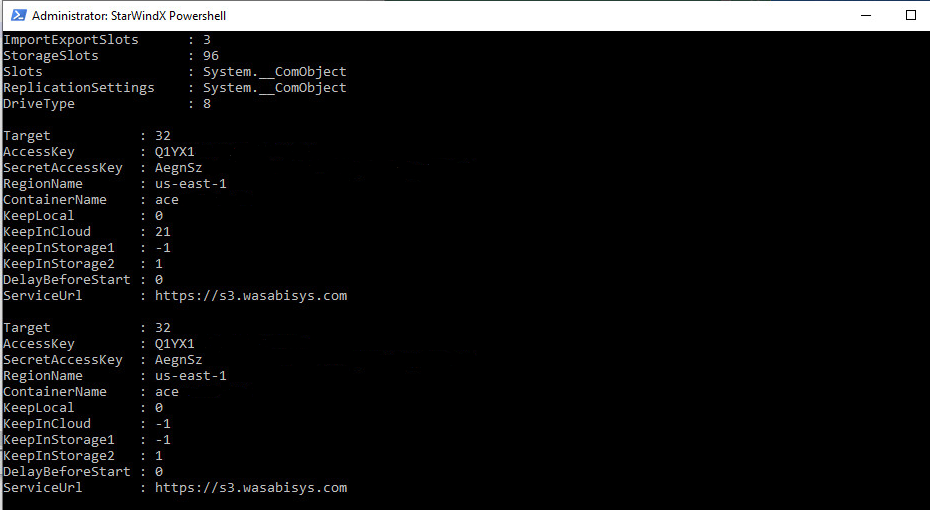

Hello all,
We have been using the free license of VTL without issue for the past 60 days. Management using the powershell utilities however is proving to be an issue as related to modification of my Cloud replication settings. Using the supplied VTLReplicationSettings script does not seem to work for me.
All of the necessary parameters have been modified to suit my environment, the access key and secret key are correct but the function $device.ApplyReplicationSettings($settings) does not appear to do what it's told. Specifically, I'm attempting to change the parameter KeepInCloud from -1 to 21 and after each run of the script the parameter remains at -1, and the script returns what appears to be a 0 exit code. Can anyone shed some light as to what may be happening?
The Management Console reports Version 8.0.0.12767
Attached is the output received after running the script.
Thanks in advance for any help.
Script results
Script results
Thu Dec 26, 2019 4:02 pm

Import-Module StarWindX
$server = New-SWServer -host 127.0.0.1 -port 3261 -user root -password starwind
try
$server.Connect()
# common parameters
$deviceName = "VTL1"
$device = $null
foreach($dev in $server.Devices)
if( $dev.Name.Equals($deviceName) -and $dev.DeviceType.Equals("VTL") )
$device = $dev
break
if( !$device )
Write-Host "Device '$($deviceName)' not found" -foreground red
return
$device
$settings = new-object -ComObject StarWindX.VTLReplicationSettings
$settings
# $settings.Target=[StarWindVtlReplicationTarget]::REPLICATION_TARGET_S3
# $settings.Target=[StarWindVtlReplicationTarget]::REPLICATION_TARGET_BACKBLAZE
# $settings.Target=[StarWindVtlReplicationTarget]::REPLICATION_TARGET_AZURE
# $settings.Target=[StarWindVtlReplicationTarget]::REPLICATION_TARGET_S3GENERIC
$settings.AccessKey = 'XXXXXXXXXXXXXXXXX'
$settings.SecretAccessKey = 'XXXXXXXXXXXXXXXXXXXXX'
$settings.RegionName='us-east-1'
$settings.ContainerName='mycontainer'
$settings.KeepLocal=0 #-1 never delete, 0 delete immediate after upload, other positive value means a day interval between uploading and removing local copy
$settings.KeepInCloud=21
$settings.KeepInStorage1=-1
$settings.KeepInStorage2=1
$settings.DelayBeforeStart=0
$settings.ServiceUrl='https://s3.wasabisys.com'
$res = $device.CheckReplicationCredentials($settings)
$res
$res = $device.ApplyReplicationSettings($settings)
$res
$device.ReplicationSettings
catch
Write-Host $_ -foreground red
finally
$server.Disconnect()

Boris (staff) wrote:WE have performed some testing in our environment and nothing has got reproduced. Could you share the script (with sensitive info removed) that you used to adjust the settings?
Hi Boris,
I have exactly the same issue with version 8.0 13481 Free license. I try to adjust $keepInCloud setting to 180 days for Azure blob archive tier storage after that $device.ReplicationSettings shows me $keepInCloud : -1 but the key <timedeletecloud>180</timedeletecloud> in VTL1.SWDSK every time properly changes.
Where is indeed actual value?
Posts: 4508
Thu Apr 02, 2020 12:39 pm
Sorry for the delayed response. Could you try setting $keepInCloud to 1 day to see if tape moves properly?
in VTL1.SWDSK looks reliable to me.
Could you try setting that value to 1 day and see if it finally works as expected?
