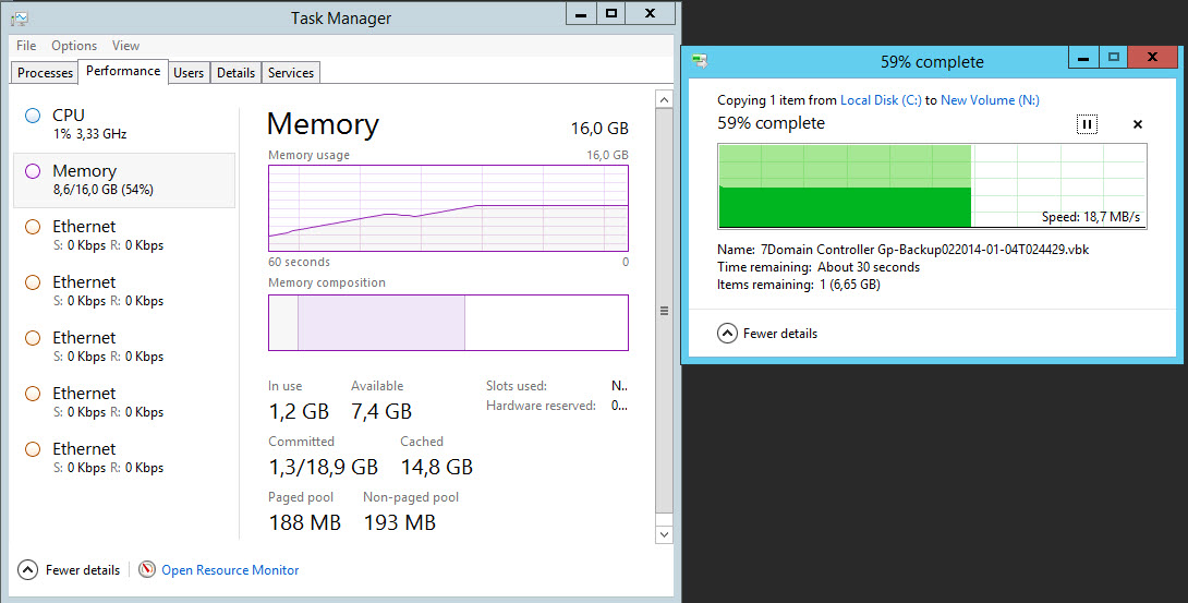

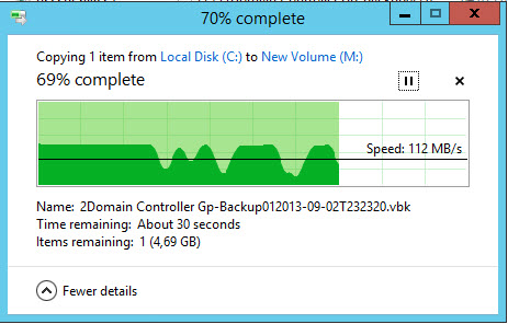

Doing first tests with Beta 3 and Starwind in general.

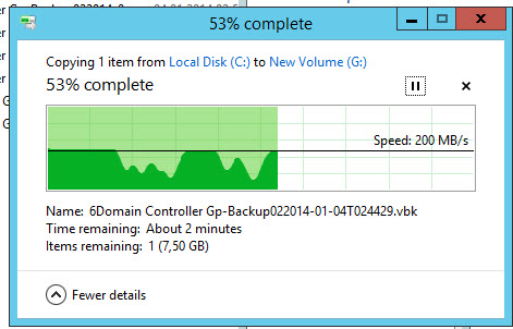

When copying files onto a Starwind Lun i tend to see massive drops in bandwith during file copy.
Sometimes i get rates around 200mb/s, and the next time i copy it will start around 10mb/s and sometimes droppes to 0kb/s for a few seconds.
Storage is exclusive for Starwind, no other running things.

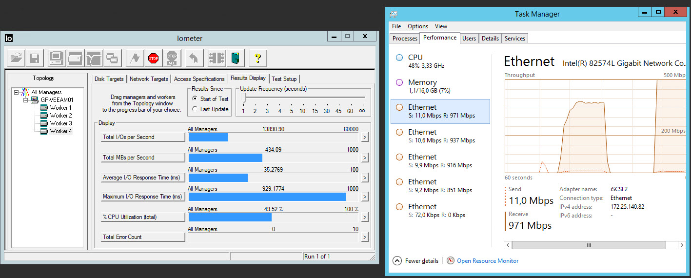

Link is 4gb (4x1gb) using ms mpio connecting to 4 target ip's on starwind so using 16 channels in total.
Iometer can max out the 4gbit/s for a sustained period.
Any ideas before getting into details?

I created 3 Luns. Both thin provisioned.
1. 150GB Lun without dedupe, LSFS Write-back Cache 1GB
2. 4TB Lun with dedupe. LSFS Write-Back Cache 4GB
3. 250GB Lun without Dedupe. Write-back Cache 4GB.
Storage Source for Lun 1 and 2 is a local Adaptec 71605Q. 6 Raid 5'2 of each 18TB (4TB Disks). So 36 Disks in Total.
Storage Source for Lun 3 is a iSCSI SAN connected with ms iSCSI. No "real" raid since it is a 20TB flash Device.
Guest seems to have enough memory free (3GB RAM reported used when drop occured this time).
Starwind Server has 256GB Memory with 33GB currenty used.
I see the same "drops" on all 3 luns
Actually we are looking to possibly replace DataCore with this system and are trying to find optimal configuration. Currently limited to the 4gb/s since existing enviroment is 100% fc, and i am wating for 10gb/s nics and switches to arrive. But i wonder anyway...
I am willing to change every setting / setup to reach better number as this is POC for Starwind.
Ps. Is it possible to change writeback cache after the volume has been created?

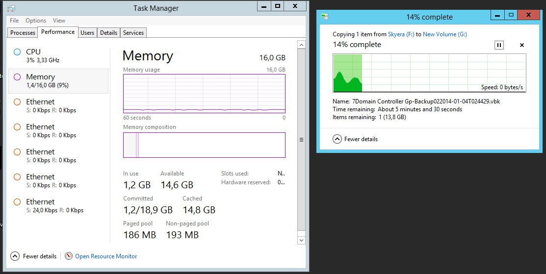

File copy from Lun3 (Flash) to Lun1 or Lun2 (DIsk) (@Guest) is even worse. Not getting over 50mb/s,
both arrays however should be able to do much more than that.
Ps. The Flash Lun is a native Lun from the Array. Lun1 and 2 are created from thick provisioned vdisks on windows storage pool (simple/stripe)

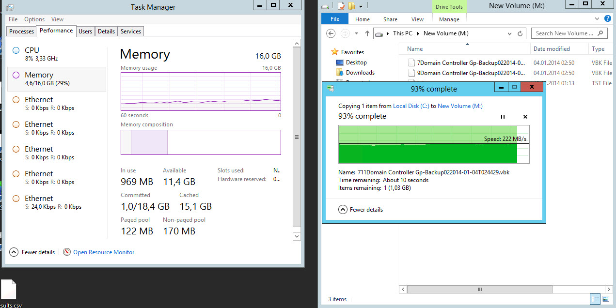

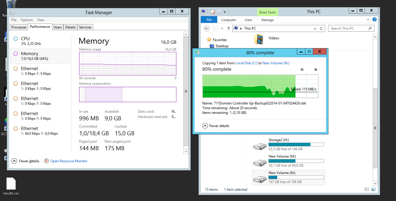

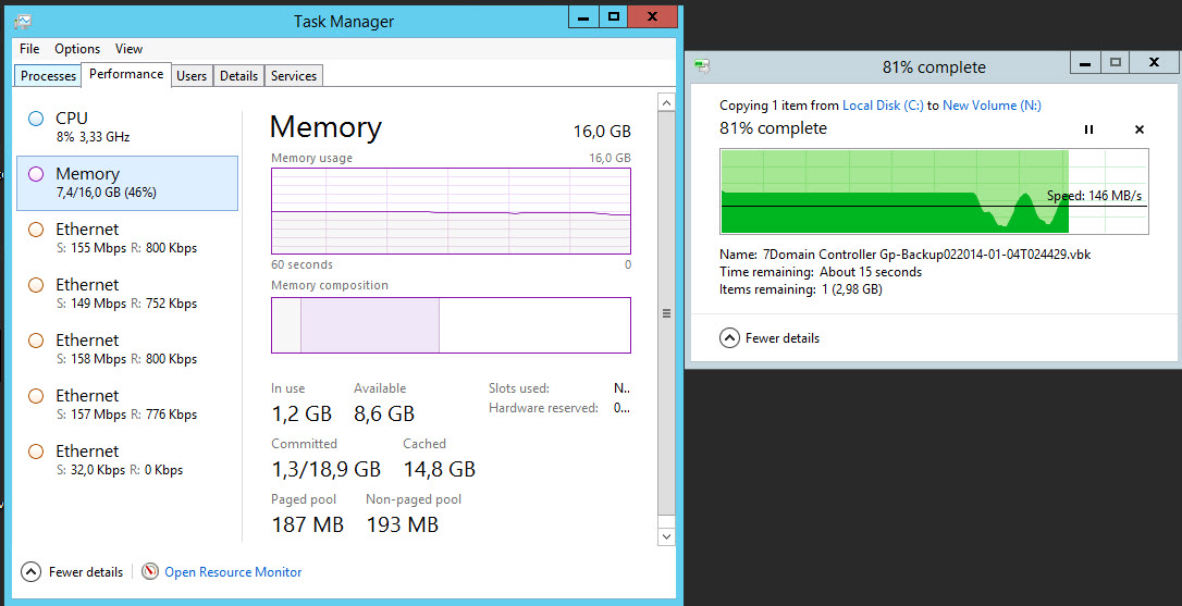

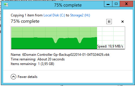

I now created 2 new Luns (Thick provisioned).
Copying to the "DIsk" Luns seems much better. However i still see a drop after about 40%. But overal pretty consistent @220mb/s
Copying to "Flash" is weird. Starts out at 220mb/s also, but after 59% speed is going toward 0kb/s and just seems to hang there...
Ps. added 3rd screenshot, where you actually see the "hanging"
Here you can see speed dropping when copying to flash

I just found TcpAckFrequency setting in one of your posts.
Will set this for all iscsi nics and let you know in the morning if it changes something...
Delo123
Posts: 30
Joined: Wed Feb 12, 2014 5:15 pm
Thu Feb 13, 2014 1:12 am
copying to the "disk" lun now works without dip,
however copying to the "flash" lun it starts dropping again around 57% as before.
However i am getting 80K iops now on the flash lun (40k before).
Still not near 250k iops i get on the starwind hostside, but ok, its only a 4gbit link...
will do some more tests tomorrow
