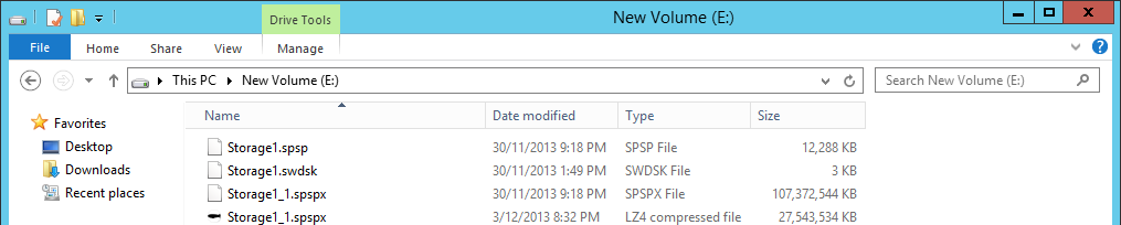

I would really like to see this in V8 release it is such a big deal when using SSDs, etc. For example currently 20x Window Server VMs installed with a few things added such as domain controllers using Beta 2 in-line deduplication. Raw Data is 302GB, Storage1_1.spspx is 102GB due to deduplication and only 26GB with compression-over-deduplication.
*** LZ4 for Windows 32-bits v1.4, by Yann Collet (Sep 17 2013) ***
Compressed filename will be : Storage1_1.spspx.lz4
Read104856 MB (25.65%)
Compressed 109949485056 bytes into 28204578273 bytes ==> 25.65%
Press enter to continue...

4kb, you can try the LZ4 out your self with your own .spspx. I used High compression level as LZ4 is really fast. http://fastcompression.blogspot.fr/p/lz4.html

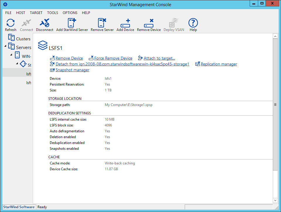

Also, just notice on Windows 2012 R2 creating a new storage even selecting the 4kb it uses 4096 block size but will create a new post about the bug once i got all the info.

There is no bug, please see the below screenshots.

2) 4KB = 4096 bytes.
