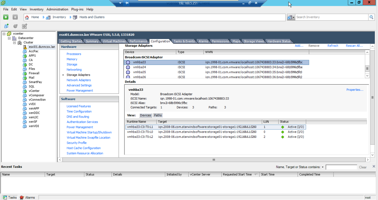

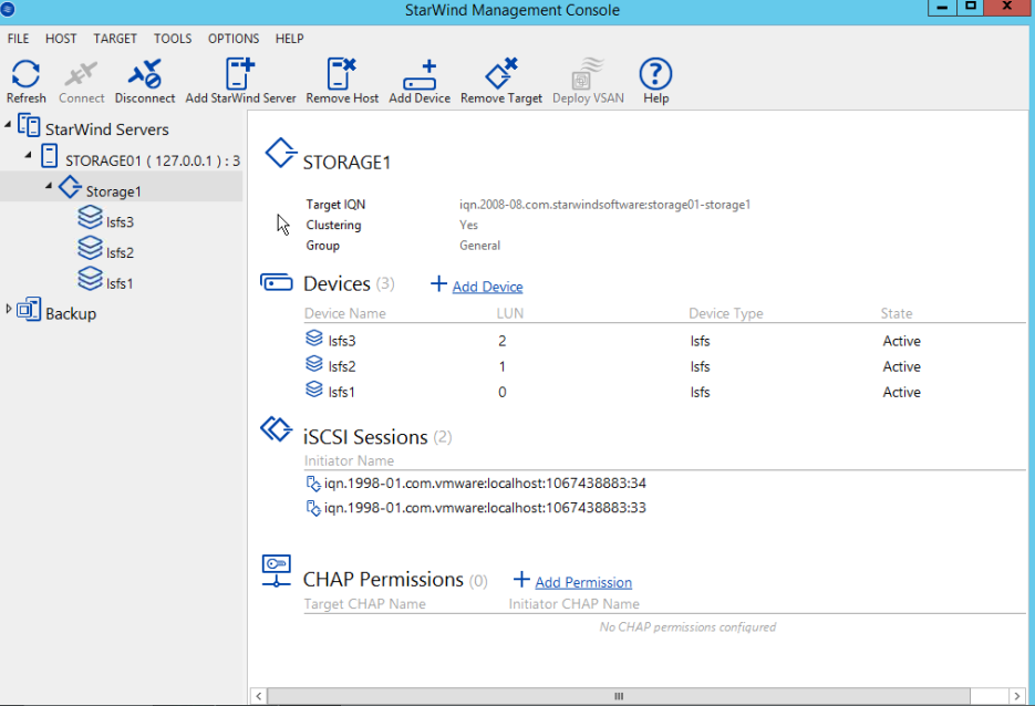

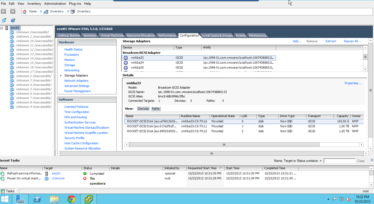

I don't know the proper way to upgrade to beta2, so I shutdown all my VM's + vcenter, and only my esxi server was running, then on my storage server just run the install, accepted the default, it completed then go an error message about SMI something ......, click ok and then when back to my esxi server BAM all the storage disappeared, I restarted my esxi server, did not find the the storage, ny the iSCSI card showed 1 target and 3 device and 3 path, so I restarted the storage server, now I could not login to the starwind management on 127.0.0.1:3261m after trying a few thing, I gave up.
Now I am back, got the management to login, all my 3 disk are there, when back to esxi but still no storage, did a little Google, and found out that if the iSCSI card is seeing every thing that just mean the datastore loss some king of id for that lun, so just add back the storage, and still it to use or keep info from the lun., and then all my VMs came back.

I also had to add storage and NOT signature after upgrade to beta2 (might bee npossible to remove VM's, rescan and then register VM's again.
