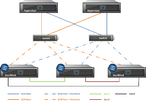

- Three active nodes for more availability. Common interconnection diagram is attached.

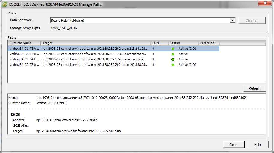

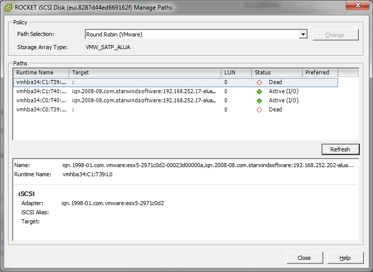

Thank you for adding ALUA support! It works!!
(edit: I see that the last image came first. The bottom picture is when both nodes are up)
Created a HA-device with two nodes, 192.168.252.202 and 192.168.252.17. The .17 one selected as non optimized path (ALUA).
When selecting round robin mode, only the paths to the .202-node is used! When shutting down SW on .202 both paths on .17 are used. Goes back to .202 again when starting SW on .202 again (after sync is done).
using non-optimized path because primary node is down.
both nodes up, using all optimized/primary paths

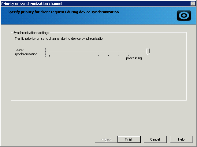

Small error in the GUI.
btw: is it possible to add a remote (other subnets) node now? In the wizard I needed to have corresponding subnets on all nodes.
How do I setup async replication?
And how to create HA dedupe device?
sync priority.png (17.46 KiB) Viewed 134914 times

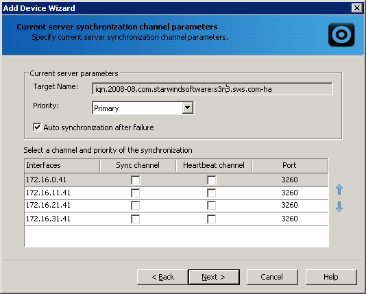

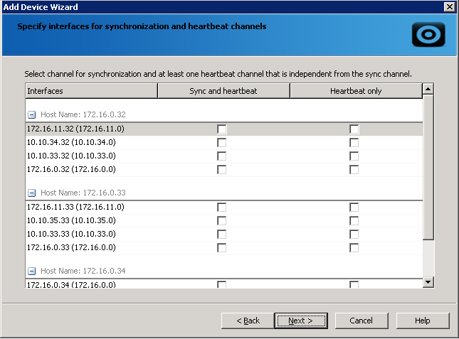

Guys,
what do you think about interfaces configuration dialog in 5.9? Here it is necessary to specify sync and HB channels for 3 Nodes, so the dialog contains significant amount of interface information.
Is the dialog simple enough and clear? Compared to 5.8 one.
Do you have any ideas how to make it better?
