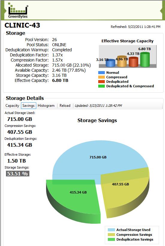

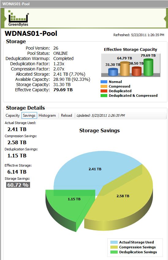

We are getting 1.5x Deduplication on some plus 2x Compression on our GreenBytes units.... I believe they run ZFS+ for their underlying store . . . .

Deduplication of 1:1.23 is not very impressive... What kind of data do you keep on deduplicated target? What deduplication block do you use? What competitors did you consider at the time you've been planning dedupe deployment?
