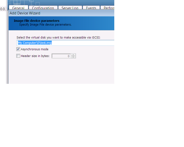

The help indicates that you should be able to make your disk image read only however when I create one I don't have the same options as in the help (there should be a checkbox between asynch & header):
No Read Only Option
No Read Only Option

blueninja wrote:Okay, after much trashing around, we got our iPXE boot to work with the Beta and an open source DCHP server.
The read-only option is present when you select "Mount existing virtual disk". No need to export new blank image in read-only mode.
