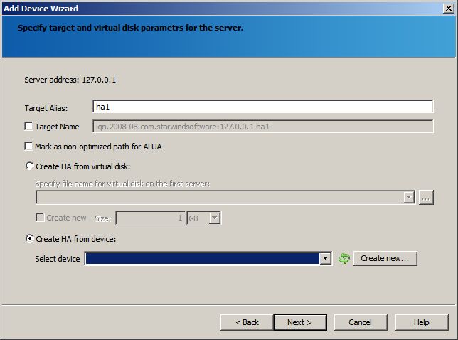

rarana wrote:Hello,
Just got of the phone with Software Sales. i asked about the third node replication for disatar recovery and i was directed to the forums. My question is when is the plus 1 package suppose to be ready for testing? is this already part of the 6.0 beta? When trying to add a third node to an HA cluster, I cannot select the sync and heartbeat channles on third node. They are greyed out. The Cluster is on the SAME LAN, while the third node I am trying to add is on another routed LAN.
Thanks,
Rommel
HA with remote replication can be configured when one of HA disks is deduplicated disk device with replica.
In management console it is necessary to select "Create HA from device" option and either select existing DD device with replica or create new one.

Ok, I am not understanding exactly how to do this. is there step by step docuemntaion availbe that i can read on how to create a depulicated disk, replica set, where to store these and so on so that my end result is at Site A i have a two node HA cluster, and at site B i have a replicated HA cluster data availvle?
Thanks,
Rom

rarana wrote:Ok, I am not understanding exactly how to do this. is there step by step docuemntaion availbe that i can read on how to create a depulicated disk, replica set, where to store these and so on so that my end result is at Site A i have a two node HA cluster, and at site B i have a replicated HA cluster data availvle?
Thanks,
Rom
Please follow instructions from this guide
http://starwindsoftware.com/tmplink/Sta ... yper-V.pdf

Thank you for the instrcutions. I am having another issue. In the instructions CONFIGURING SHARED STORAGE on Step 10 where it says target for Data the target name never appears no matter how long i wait or if i click refresh many times. i am testing with Server 2003, do i need server 2008 or 2008 R2? i am able to initate the target from Microsoft iSCSI iniator but from that part in step 10 it never populates.
Thanks,
Rom

rarana wrote: i am able to initate the target from Microsoft iSCSI iniator but from that part in step 10 it never populates.
Thanks,
Rom
Are you talking about MS iSCSI initiator installed on the StarWind machine?
We need StarWind logs from the machine where you are trying to create DD device with replica. Please send it to beta-testing@ e-mail.
rarana

Yes, initator from MS iSCSI but in step 10 it is asking me to chose a target but nothing ever populates. how can i get logs for you?
-Rom

rarana wrote:Yes, initator from MS iSCSI but in step 10 it is asking me to chose a target but nothing ever populates. how can i get logs for you?
-Rom
I mean you are talking about the initiator on the same machine as StarWind Service. Right?
You can find the logs in C:\Program Files\StarWind Software\StarWind\logs directory.
