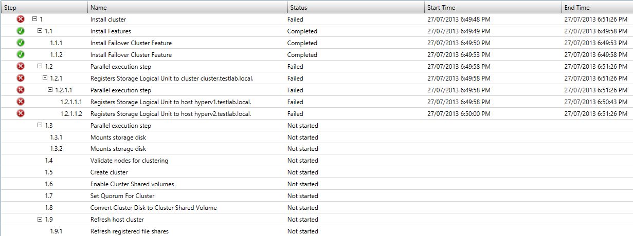

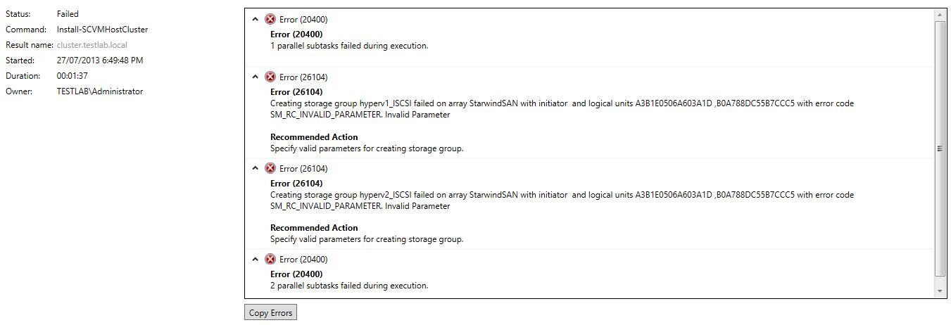

Hi I'm trying to create a 2 node Hyper-V cluster using SCVMM 2012 SP1 (Server 2012) with Hyper-V R3 nodes (Server 2012) in a lab environment using the iSCSI SAN (a Server 2012 VM) and SMI-S Agent (v1.0).
I've followed the instructions in the "Using-StarWind-SMI-S-Agent-with-SC-VMM-2012-SP1.pdf" and can successfully create LUNs in SCVMM and attached individual disks to Hyper-V nodes. However if I try to create a Hyper-V Cluster using the created LUNS (1 for quorum and 1 for data) I get the following errors.
I can confirm that both Hyper-V hosts are attached to the storage array since I can add individual disks to a single host successfully through VMM using the SMI-S agent.
Has anybody seen this before?

here is the detailed errors for previous post

nstylin777 wrote:Hi I'm trying to create a 2 node Hyper-V cluster using SCVMM 2012 SP1 (Server 2012) with Hyper-V R3 nodes (Server 2012) in a lab environment using the iSCSI SAN (a Server 2012 VM) and SMI-S Agent (v1.0).
I suggest you to wait for StarWind V8 beta + StarWind SMI-S Agent V1.0 beta and to try it again.
We have a lot of improvements that should solve many problems.
Thank you for understanding!
Yuriy.
