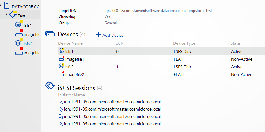

Got the new version, it now gives indication that an Image file failed :)

hmm... the LSFS LUNs failed to mount also

Ironwolf,
1. ImageFile issues: ImageFile devices don't support disks with 4k block size now. Previous versions allowed to create devices on such disks, but devices could function incorrectly.
Now we have added check for 4k block size at the stage of device initialization.
2. one of structures of LSFS devices has been changed in the latest build of 8.0 beta. It led to incompatibility with LSFS devices that have been created with previous builds.
LSFS devices on the disk with 4k block size should function properly. You can just re-create LSFS devices.
It's possible to add backward-compatibility for this case, but we decided not to do it, as these are beta-builds, not releases.
Thank you for feedback!
