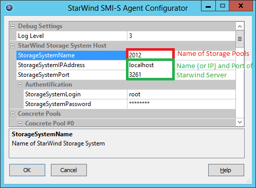

4. In the StorageSystemName field, define the name for a new disk array.
5. Specify address of a host where StarWind iSCSI SAN is launched. Leave the port number as is.

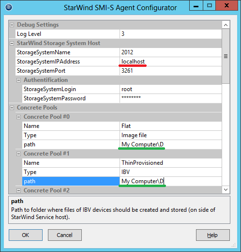

6. In the Path fields, specify the actual paths to the folders where you want to locate disk device image files. The value in the Path field is defined for a server where iSCSI target is located. This value should have the same format as virtual devices in StarWind iSCSI SAN.

In our configuration, Starwind Server and SMI-S Agent are on the same server. But you may specify another server with Starwind Server.
StorageSystemName can be any. It’s name will be present in VMM.

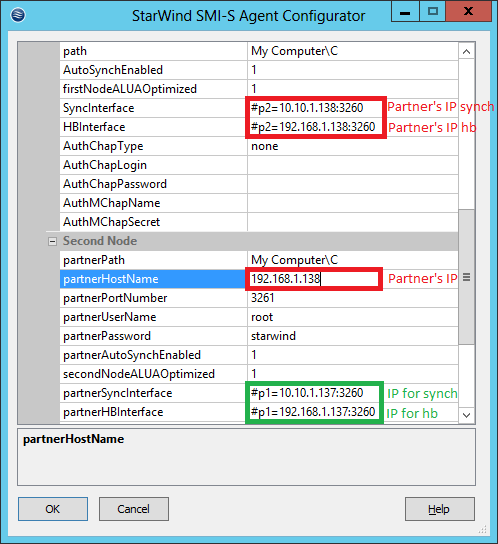

Here is the settings for one target server configuration.
You should specify only name (or IP) of Starwind Server and paths for Image file and IBV devices. Ignore all HA settings.

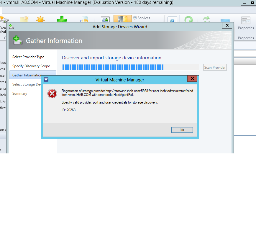

i made scsi storage in starwind then i went to my scvmm first i add these storage then i foud probllem on it i deleted them .
now when iam trying to add them again its give me this error .
any solution for this?

Everything works until i get to page 13 - Step 3 and no matter what i do I cannot get it to work right (select the checkbox and then have only the arrays that are visible to the whole group show up) - the arrays always disappear from the list.
I suspect the issue is in the SMS-S configuration, when I set the IP address it always reverts to localhost instead of the address i put in. Could that cause the other machines not to see it?
