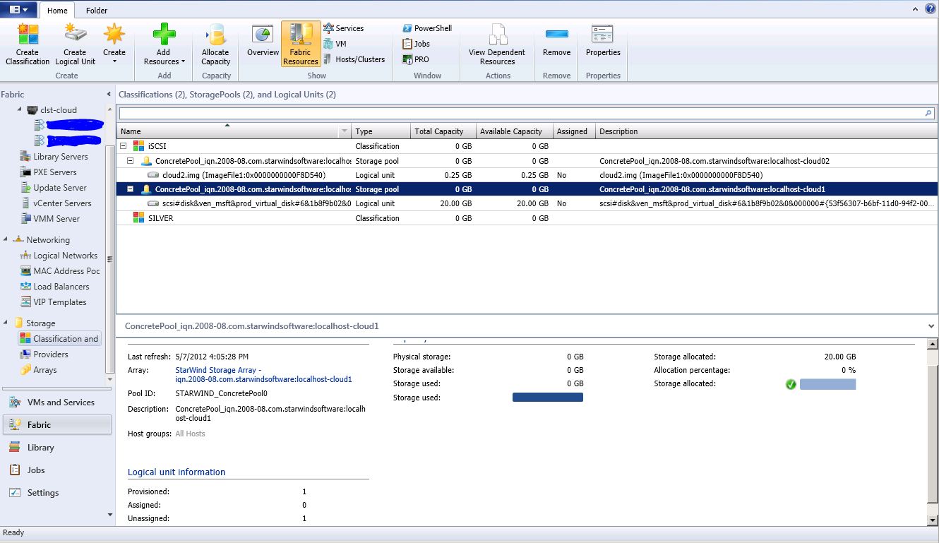

Dear StarWind team,
we had built test environment using StarWind iSCSI software and System Center 2012 Suite.
We have :
VMM 2012 version 3.0.6005.0
StarWind version: 5.8.19.64
SMi-S provider driver - v.0.6 preview
We have Hyper-V cluster environment (2 nodes) based on SAN Storage. VMM and Storage server with iSCSI software installed on VMs.
Storage server has 1 additional virtual disk - device for iSCSI target.
Can you describe configuration steps for Private Cloud configuration using iSCSI software with SMI-S agent.
We have the following problem:
When we add new storage provider to VMM using StarWind SMI-S, we can't assign this storage pools to Private Cloud.
In attach you can find additional screenshot.
iSCSI storage
iSCSI storage

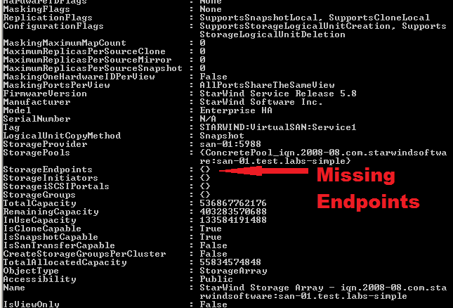

EDIT: After further research here is what I found:
When I "Add Storage Device" in SCVMM2012, it in turn queries the Starwind SMI-S provider for information.
It seems that the SMI-S provider is not returning any data regarding the "StorageEndpoints" for the SAN/Array.
Hence when I try to add the Storage Array to a Hyper-V host, SCVMM2012 queries the iSCSI targets on the host and tries to match those to any available "StorageEndpoints" on any known Storage Arrays. Now, it can't find a match, because SMI-S didn't return any, and in turn doesn't enable the "iSCSI Array: Add" button in the Storage section of the host properties.
I'm getting this: Image
Should be like this: Image
This would also be the cause of the "warning 26130" error mentioned earlier when Allocating Capacity to Host Groups.
It would appear that the current SMI-S provider (v0.61) is incomplete in its integration with SCVMM2012. As it stands one cannot make use of Rapid Provisioning, Storage Allocation (to host groups) and other SMI-S dependant storage automation features.
To test for this condition:
Open the VMM Command Shell (Start > All Programs > Microsoft System Center 2012 > Virtual Machine Manager > Virtual Machine Manager Command Shell)
To query a host for iSCSI targets use the following:
$ht = get-scvmhost -computername <Host Name>
$ht.InternetSCSIHbas[0].targets | ft name
To test if the endpoints are populated (If values are returned then great! Otherwise they are empty):
$SArray = Get-SCStorageArray -name <Array Name>
$SArray.StorageEndpoints | ft address
Important: To succeed in using a Storage Array with a Host a match needs to exist between any StorageArray Endpoints and any of the Host Targets.
To get an overview of what all information about your storage arrays:
$SArray
Missing Endpoints from Starwind SMI-S provider.
Yuriy (staff)
Posts: 56
Wed Jun 06, 2012 9:04 am
Steves,
Thank you for your VERY detailed reply. Now I completely understand your needs.
steves wrote: Is this currently not supported or am I just missing something on my end?
The preview version of SMI-S provider is incomplete in part of reporting of "StorageEndpoints".
We will implement this feature in near future.
Thank you again!
