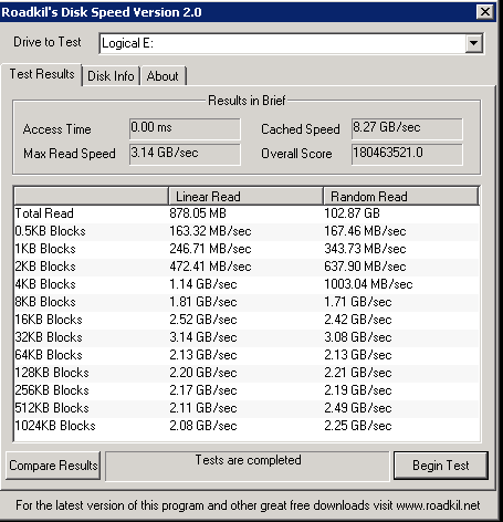

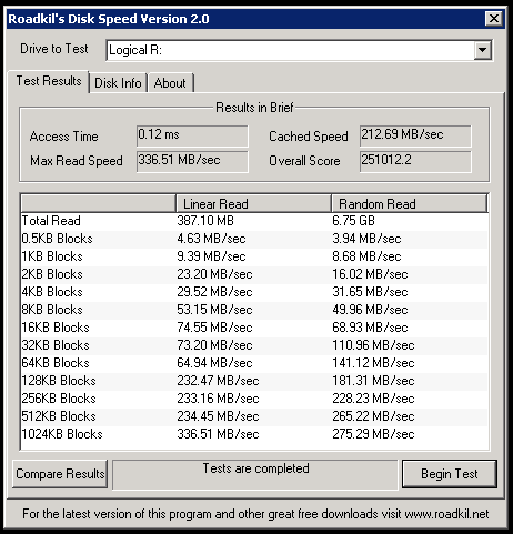

Having same issue, StarWind RamDisk Software (non-iScsi) very fast 2+GB/s, but RAM-based iSCSI target on localhost very slow. This is on clean 12-core Win2008r2 128gb server with no other activity.

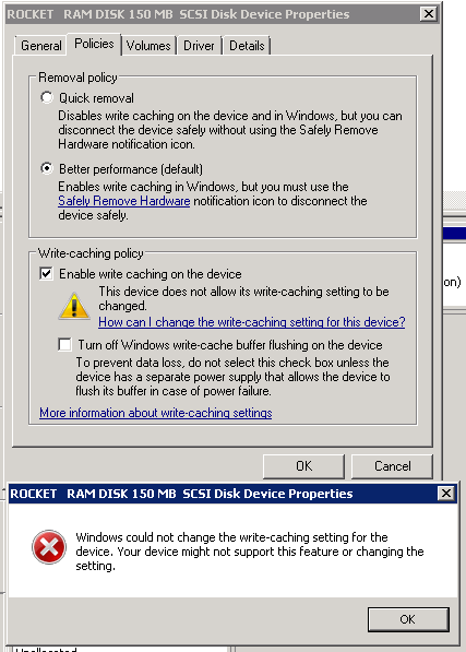

Also, Win2kR8 will not allow any write-caching on either Starwind RamDisk Software or iSCSI Ram Disk.
When i try to enable write caching and hit OK on first dialog box shown, the alert comes up that says
"Windows could not change . . . ". Same thing happens if I also tick the second checkbox "Turn off Windows write-cache buffer . . . "
Seems nothing I do makes this iSCSI Ram Disk anywhere near the speed of the StarWind RamDisk Software.

2) Inability to turn ON caching for RAM-based media is a FEATURE and not a BUG :) You don't want to add extra path for increased latency, do you?

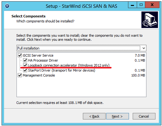

Hi
Please update your StarWind installation and make sure that "loopback connection accelerator" component is selected.

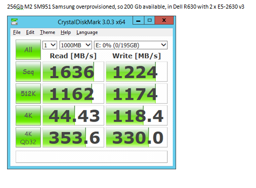

- SQL server logs: 256 Gb M2 SM951 Samsung drives (30% overprovisioned, so 200 GB or so available) (sync'ed)

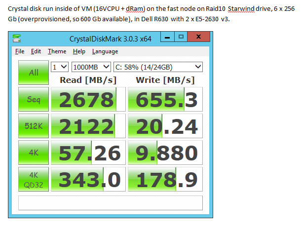

So, in the end, our problem does appear to be the same as what the people above described, I.e. when we install the standalone version of Starwind Ramdisk, there are no performance issues. However when putting it as a (non-synced) iscsi target (either as physical drive or as image file on top of an earlier created Ramdisk), the performance drops by a factor 3 or so (it was just because our nodes are so fast, and we use DDR4 memory that the performance was still acceptable on the first node).
But this performance difference made us wonder and we decided to check the performance of the storage on which the hyper-v VM's run (as we had only checked the storage performance before we created "image file"-based iscsi targets on them). Unfortunately, also there, the performance is about a third of what the underlying storage fabric is capable of (the hypervisor should not slow it down to this extent). Now, I doubt we have done anything wrong with turning, as we have build a standard 2-node cluster and all settings are as per the book (jumbo frames, GPT, well everything..), and we are using the latest v8 build which I believe includes the loopback accelerator. So, maybe this is all related to your warning "not to use the free version for performance testing".... but the funny thing is, that when we do the live migrations, it actually is very fast (over 2 x 40 GBE connectx-3, also new 250 GB image file creation is synced in no time). So the replication from node to node as governed by SW appears solid. So maybe our drive performance loss when is something related to iscsi itself or so (we anticipated a bit of performance loss due to iscsi, but not like this).
We will investigate a bit further and post if we resolve, but for now, we unfortunately also could not get the embedded SW RAM disk to work to acceptable standards on both nodes.
Regards, JJ
PS. For your perusal, I attach the crystal disk output of the storage performance inside a VM that resides on the SW storage (please note, there is just 1 VM on that machine, and we could not detect any network activity on the host whilst testing, so the outcome of the test was likely not influenced by any networking bottlenecks). The performance of the underlying Raid10 storage on which this VM resides, is attached to my earlier post.
