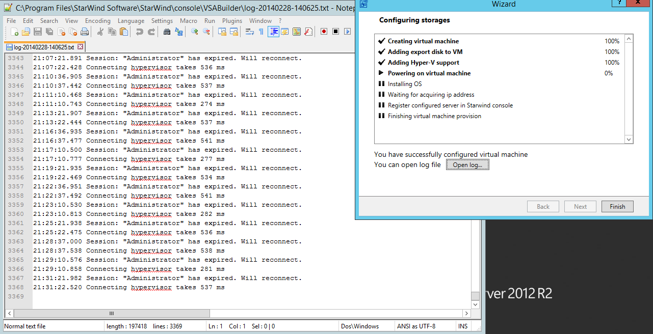

Just saw this on the toolbar, and decide to try it.
It ask for Hyper-visor address: This is not the vcenter address right ?
anyway i use the esxi ip.
for the windows iso, i use the server 2012 R2 iso from the datastore, that's been use to install my domain vm.
i also downloaded the sw-vsa-20140116.iso and add it to my datastore.
Can you explain how this work? and how it works with the iSCSI i have installed on my Storage server ?
oh my, when it started to create VM, i realize that i may have made a mistake, the 3rd task on the list is "Adding Hyper-V support", does that mean this option is not for ESXi ?
This installed on the LocalDataStorage in my esxi server, what is the HD space needed for this?
it created 2 Virtual Disk, one 82GB and the other 53GB.

FAILED !!!!! LOL

You could find answers to most of your questions in StarWind help.
Look: Help – Help Topics. Chapter about VSA: StarWind Functionality – Virtual Storage Appliance.
For installing Hyper-V Core guest some options is needed. So In this step VSA Builder adding them to VM.
About space for VM: you need 50GB for a system disk (where OS and StarWind service will be installed) and second one will be used as a storage for StarWind devices files, so you could calculate how much do you need.
And about the error – is it single Widows edition iso or multiple edtion one (standart, enterprise,datacenter)?
