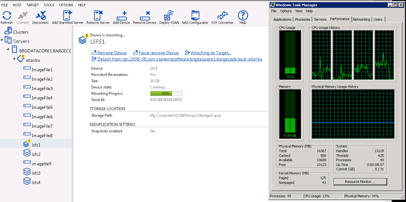

Recently load up RC,
I've seen a great number of improvements, :D
the 1st lingering problem I have seen in testing so far is long mount time of one of the LSFS lun's this is the same thing I had seen on V6 with dedup LUNs one of them always takes forever to mount on a reboot
The testing LUN size is only 10GB so it only took about 10-11 min, but on larger LUNs in V6 it could take 45min or more
127.0.0.1-3261-service-starwind-20140307-083101.zip
(12.73 KiB) Downloaded 1164 times
Long Mount time 10GB size.PNG (65.24 KiB) Viewed 13739 times

It is possible for you to edit StarWind.cfg file, set <LogLevel value="3"/>, restart StarWind service, reproduce the issue and send us that log?

Of course I was not able to fully reproduce the issue related to this, it does seem dependent on the amount of data inside the LSFS and how much deleting copying I had done to the LSFS LUN, empty disk took little time to mount. Yet in all cases while mounting little to no disk activity.
LSFS Long mount time 10min 1%.PNG (73.37 KiB) Viewed 13607 times
LSFS Long mount time 8min 1%.PNG (75.58 KiB) Viewed 13605 times

Unfortunately this is not the <LogLevel value="3"/> log and that's why we can not find the root of the problem... L3 logs may help to find what's wrong.
