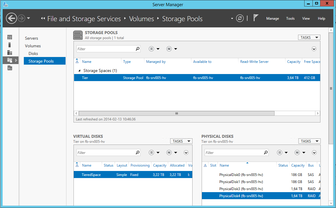

I think you should reconsider Storage Spaces. Waiting for Starwind8 we have a new hyper-v cluster running storage spaces. The setup is 8 x 900 GB SAS disk and one Intel PCI 910 SSD as cache and Tier0 layer. We created one large lun with 10 GB write cache and the performance is "like" PCI SSD on all the disk.
Writes go to the SSD and read usually is on Tier0, if not, the Tier1 (SAS-disk) is mostly idling and there for responsive. If you create the hyper-v vhdx files using logical block size of 4k the performance in the VM is almost the same as on the lun and the lun performance is almost as the Intel PCI SSD.

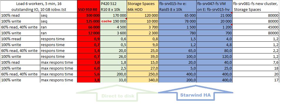

The bad Starwind performance can be explaned with 512 blocksize of vhd and Raid5.
The Storage spaces setup far to right is unsupported. We run 2 LUNs from a HP Raid controller and the 2 SSD disks from the SSD, a total of 4 disks and Stripe them in Storage spaces.
We can see a huge difference in performance, syncing our file server with DFS-R the uplink to the old file servers was the bottle neck. The new VM is behind 10 GBit, live migration network 10 GBit and, when v8 is stable, 4 1 GBit NIC as sync and 2 1 GBit NIC as initiators.
SMB 3.02 between the 2 identical cluster/hyper-v servers makes file copy or live migration, replica etc. fast. About 540 MB/s actual throughput.
It will be interesting to how Starwind L2 cache can fit in to our storage and if that can bring any benefits over just "simple" HA on storage spaces disks.

Yes, we compare raw disk performance with the performance we get from different layers, Starwind, Hyper-v etc.
a) Standard HP Proliant DL380 Gen8 v2, 2 CPU, 96 GB ram, 8 10k SAS disks behind a P420 raid controller with 512 MB cache. (our initial plan was to run behind a SAS controller H220).
The cluster have two connections to the network, 10 GBit for VM workloads and 1 GBit for management. The rest, 7x 1 GBit NIC and 1x 10 GBit is direct attach cables betwen nodes.

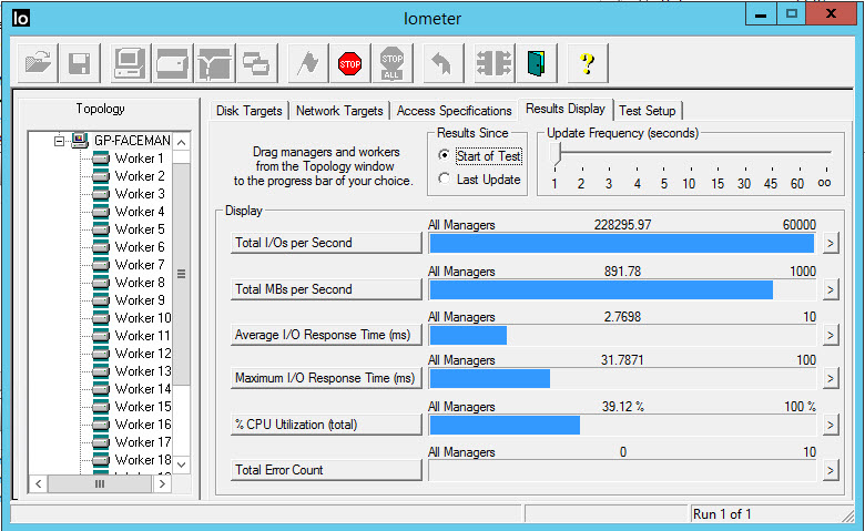

IoMeter on Starwind Host: (Simple Disk, no SS)
This is IOMeter on the Starwind Host. Disk from Backend Storage, giving around 200K Iops

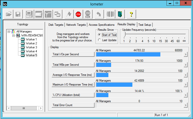

IoMeter on Windows Guest (VM): Dedupe and Caching is ON. Low IOPS and i see no iops coming from the backend.
IOMeter in Windows VM. DataStore is VMFS. Caching and Dedupe are on.

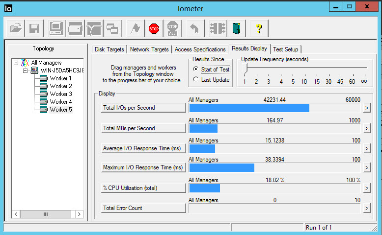

So i decided to turn off cache: (Still seeing no Iops on Backend)
IOMeter in Windows VM. DataStore is VMFS. Caching is off and Dedupe is on.
