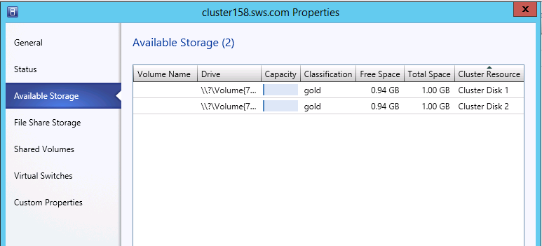

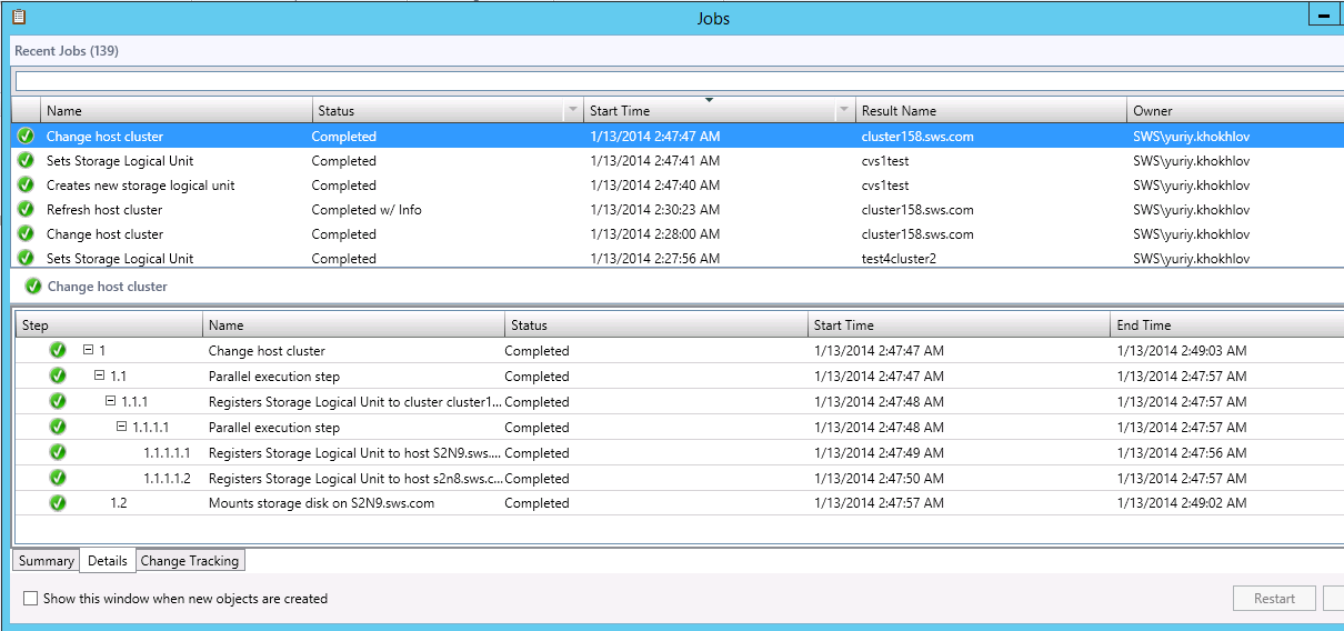

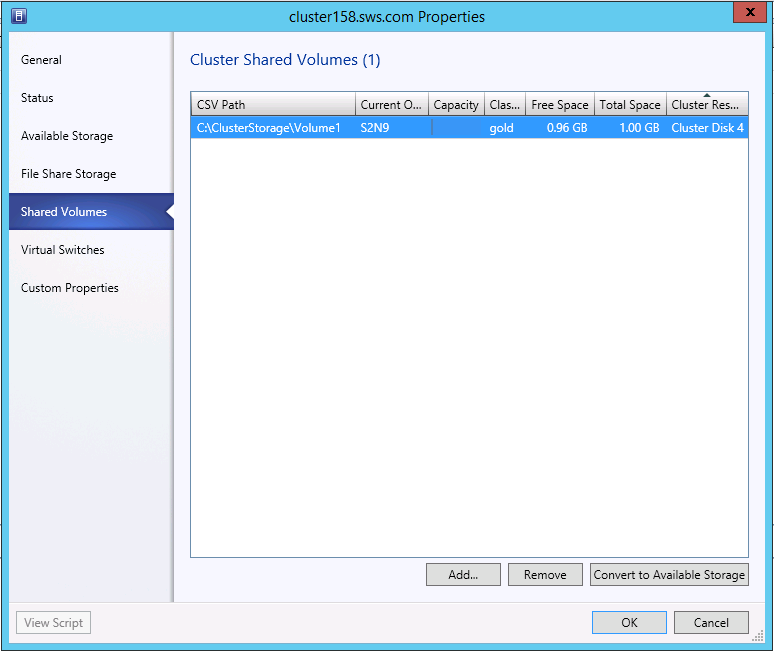

Yes, it is fully supported configuration. I just created one CSV and two "Available Storage" on our lab cluster (it was tested for case of Windows Server 2012 and for case of Windows Server 2012 R2).
See screens attached.
I checked in my environment that:
1) All cluster hosts have MPIO installed
2) Proper VMM Agent installed on every cluster host
3) All initiators have our iSCSI Server host in the Discovery Portals list (see my next post with screenshot)
