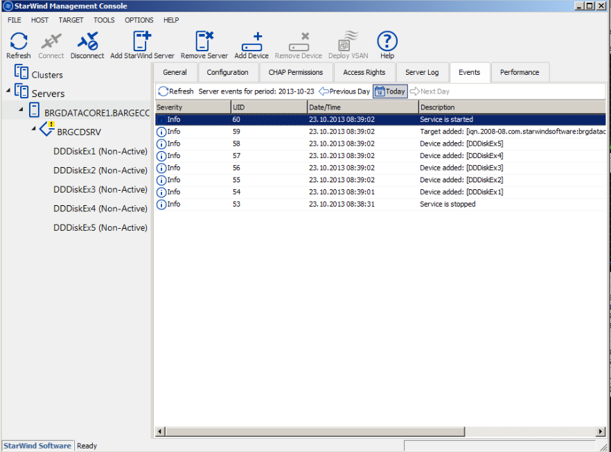

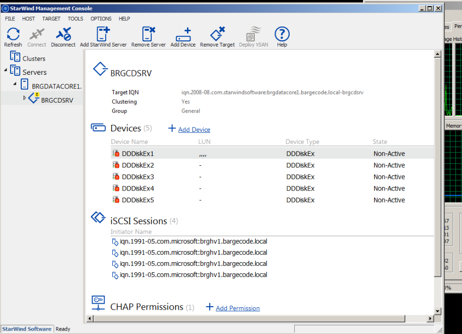

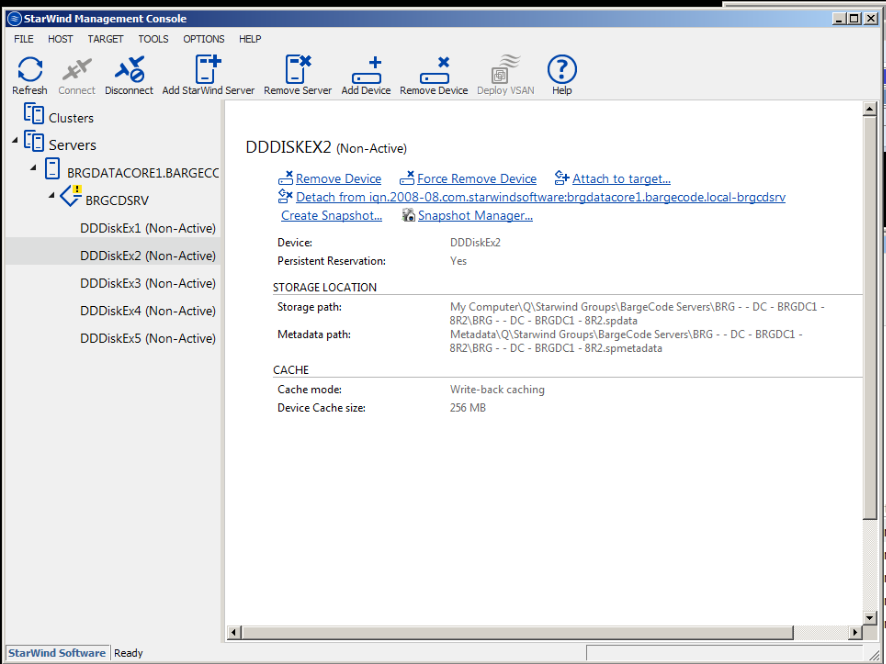

Beta-2, Dedup from version 6 are still not working at least for me, my current solution is to copy the contents out and into a new Thick IMG Lun that does work in V8
DDisk non-active event log.PNG (133.57 KiB) Viewed 11183 times
DDisk non-active detail.PNG (126.57 KiB) Viewed 11187 times
DDisk non-active.PNG (138.96 KiB) Viewed 11188 times

Thanks for the feedback.
I can confirm that this was the best solution for your case.
Currently we are working to make upgrade process painless.
