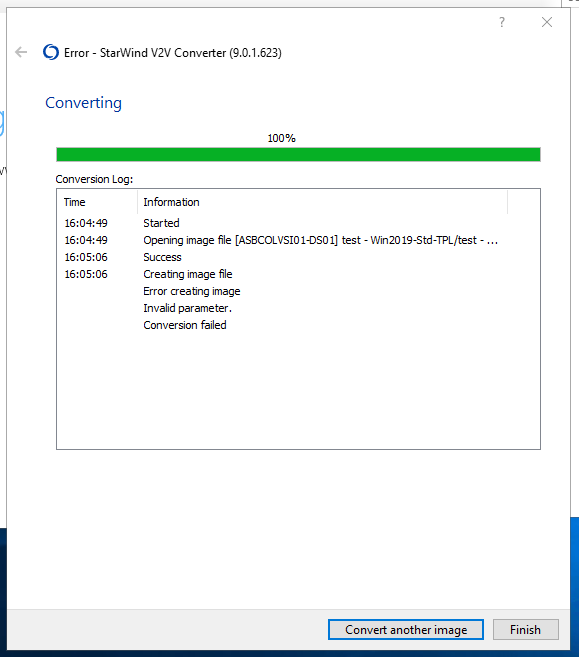

Hi, I am using V2V to convert VMware machine to Hyper-V. I powered off the VMware VM. I provided the remote source VCenter, and remote destination Hyper-V server, and Virtual Machine Path. I click 'Finish' and the conversion starts. The 'Converting' screen displays and shows 0%. Then, a few seconds later it jumps to 100%, and the 'Conversion Log' displayed on screen shows these four time stamped events:
1. Started
2. Opening Image File
3. Success
4. Creating Image File / Error creating image / Invalid parmeter. / Conversion failed.
I checked the log file and I see 'INFO' entry "...pathOutput: D:\VMs\Test-AsbCoLWca01\Virtual Hard Disks\Test-AsbCoLWca0.vhd". then, a few lines later I see 'ERROR' entry "...CVHDXFile::NewFile: File extension is not VHDX."
So, why does the PathOutput list a VHD extension, but as per the error it seems like it wanted a VHXD extension? Does this have anything to do with the failure? Any help is appreciated. Thanks.

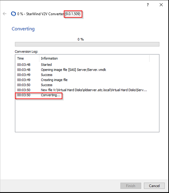

Sat Mar 01, 2025 5:07 am
This is a regression issue. I have no interest in converting individual disks by hand. 9.0.1.509 functions as expected.

Sat Mar 01, 2025 5:15 am
Thanks for your update. I can't provide the ETA for the workaround. Please use the previous converter version if it works.
My colleagues will look into the logs. Many thanks for your cooperation!

Fri Mar 14, 2025 11:14 pm
Hi, Downloaded the new version and it errored out in a similar manner
