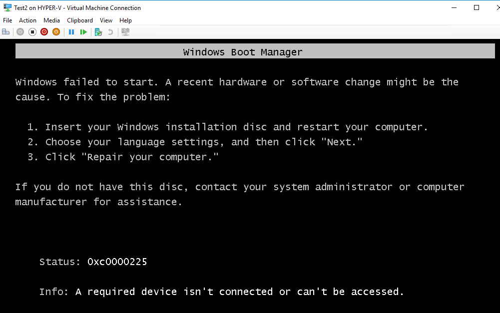

Hi ,
I have used v2v older version successfully converted machine to Hyper-V. When i powered on the VM getting error. I am attaching the screenshot
windows error.PNG (28.03 KiB) Viewed 55022 times
Re: live vm migration
Posted: Mon Nov 25, 2024 3:07 pm
by yaroslav (staff)
The issue seems to be related to the residual drivers from the source environment as the converter ran without errors.
Please try removing the VMware tools. This might be what is clashing with conversion.
Please also try booting the VM with the IDE controller attached.
Check also this out https://www.erniecosta.com/2020/02/26/h ... t-drivers/.
Posted: Tue Dec 03, 2024 9:51 am
by Mohammad
When i migrating VM of bios mode from VMware to Hyper-v ,i am getting error snap is attached for reference
Mohammad
BIOS error.PNG (27.41 KiB) Viewed 54044 times
