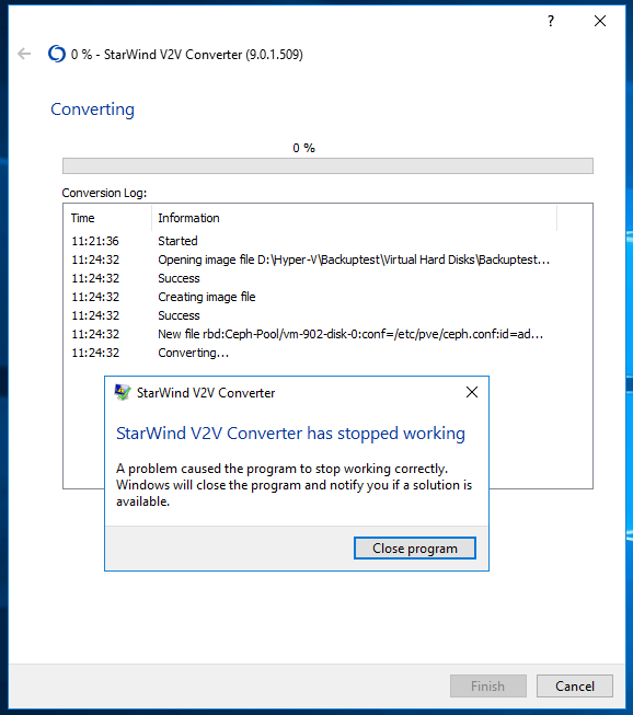

Hello, I require a bit of help. We are trying to migrate some VM's from some Microsoft Server 2016 hosts over to Proxmox 8.2 but the converter is crashing (StarWind V2V Converter has stopped working) at the start of the process. We have tried running the converter on multiple hosts and laptops, changing the Proxmox storage location and all have the same result. Attached is a screenshot and below is the (shortened to get under character limit) log of one of the unsuccessful conversations, any help would be greatly appreciated.
Screenshot 2024-10-10 113155.png (37.71 KiB) Viewed 6609 times

Welcome to StarWind Forum. This is a known issue. Waiting for the build to arrive.
