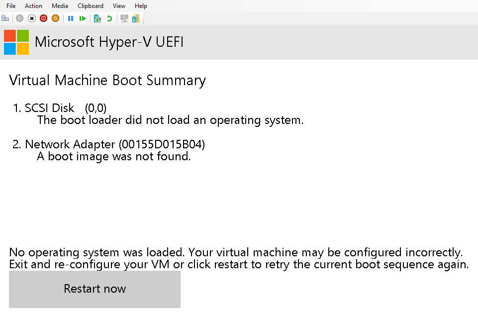

Thank you. I tried creating a new VM and chose "Use an existing virtual hard disk" where I pointed to the vhdx file. When launching the VM, I get a Boot Summary message that the OS was not loaded (see attached).
I have disabled secure boot. I don't know what other settings can affect the boot process.
Please let me know what I am doing incorrectly.
Thank You.

Tue May 28, 2024 4:56 pm
Try connecting the disk to the IDE controller and boot. Also, hook up that disk to an existing VM to see if data is doing well.

I do not know what IDE Controller means in the context of VMs. Is that a setting that I can change in Hyper-V Manager? I can see that the hard drive is attached to the SCSI Controller.
I would prefer to create the entire physical machine from V2V migrator, but I can't get past the HostName using "localhost" because of the Invalid Namespace dialog. I think that would be a better approach than connecting the hard disk. I need the OS from my physical machine intact.
What should I try next?
Tue May 28, 2024 9:35 pm
There are two types of controllers: IDE and SCSI. See more at https://www.ubackup.com/enterprise-back ... -scsi.html. Try Gen 1 VM and IDE controller.
