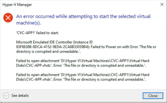

Last night, after the V2V Converter successfully migrated the VM from VMware ESXi to a new Hyper-V host I attempted to power on the virtual server from Hyper-V Manager. But it failed to start. I attached a screenshot of the error to this post.
What went wrong? Is this issue with the migration of the VM able to be resolved?

Hello @yaroslav,
first thank you for this helpful tool
i have same Problem
I am not a QA ^^, but I will try to describe the problem in my case in detail
so,
9.0.1.544
1. same Problem for Linux VM (AlmaLinux 9 XFS/LVM UEFI VM Gen 2) (2 Disks, first 50GB, second 250GB) VMware to Hyper-V (vmdk to vhdx), conversion is successful, but problem only with second disk (like on screenshot in this topic), VM not started
and plus the converted VHDX files is missing the last character in the file name, but it no problem
9.0.1.509
2. Linux VM (AlmaLinux 9 XFS/LVM UEFI VM Gen 2) (but only 1 Disk 50GB) VMware to Hyper-V (vmdk to vhdx), conversion is successful, no problem
and plus the converted VHDX file is missing the last character in the file name, but it no problem, VM stated without Problem
3. Windows VM (Windows 2012/2016/2019/2022 NTFS UEFI VM Gen 2) (1 Disk VM 90GB) VMware to Hyper-V (vmdk to vhdx), conversion is successful, no problem
4. Windows VM (Windows 2012/2016/2019/2022 NTFS UEFI VM Gen 2) (3 Disk VM first 90GB, second 1TB , third 1,5TB ) VMware to Hyper-V (vmdk to vhdx), conversion is not successful because the converted VHDX files is missing the last character in the file name and 2 Disks (first and third) have same name
conversion for only third disk is successful, VM stated without Problem
so, i converted first Linux VM with 9.0.1.268 without Problem and VHDX files have all characters
Can you please release a fix for new Version of Converter
Thanks and Regards

Thanks for your update and such a detailed description. I will pass this information to my colleagues.
We are aware of the issue and my colleagues are working on a resolution.

Sadly no. Please use the previous converter version.

Sharing one from the thread above (it works https://drive.google.com/file/d/1hDP4gl ... sp=sharing)

It is a known issue. Working on the fix.
