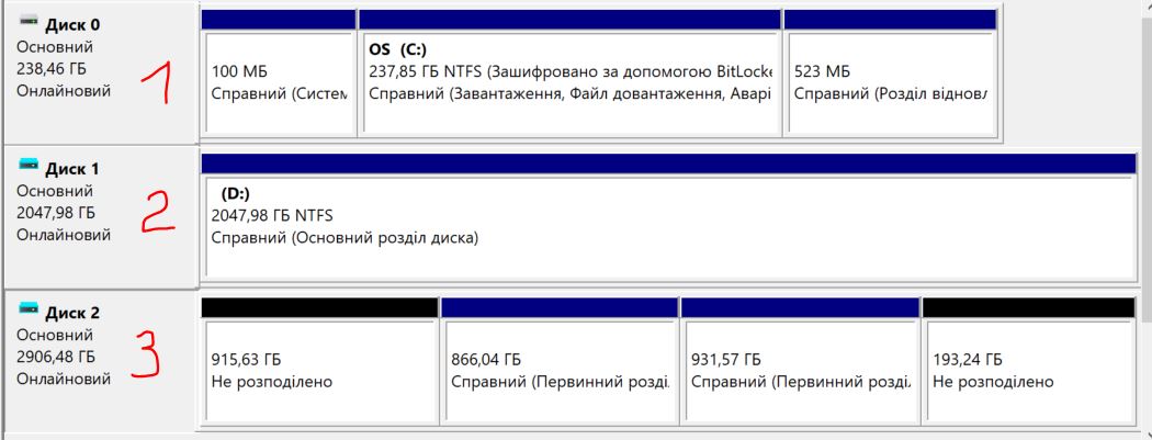

My SSD drive (have 1 parition 2TB size) started behaving strangely (reading speed was very slow in some places), so I decided to make a copy of it, and then play this copy on another drive.
I run V2V Converter -> P2V -> Disk Volume -> select volume D: (1.8TB size) -> Local file -> VHD/VHDX -> VHDX growable image - set destination file name E:\SSD_2TB.vhdx and click convert.
As result, I have file (size 1.15TB) stored on drive E:\.

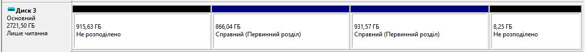

When I connect this file on Windows Disk Management, I can't see my files. Only 4 partition of inexplicable size without letters, 2 of which are not marked at all.
In 7-zip I can open this vhdx file and can see my folders and files. But when I extract to new drive folders and files, timestamp not correct.
I understand that if I was making a copy of a physical disk and not a partition, then this would not happen. Unfortunately, I no longer have the disk from which I made this copy, so I cannot make it again.
Maybe there is some solution, how can I restore all the data from this virtual partition to a new disk?

I tried to convert my vhdx file to vhd, to vmdk file and try open this file in VM (virtualbox, vmware workstation). But in these VMs, the disk also looked divided into 4 partitions and without data.
But I still managed to mount this volume and copy the data to the new SSD drive with save datastamp. I used the utility OSFMount, and at the end I indicated that I was mounting a Logical Drive Emulation, not a Phisical Disk Emulation.
I also decided to simulate my situation again. I created a 2TB virtual disk (vhdx) using Windows tools. I created a partition on it that takes up all the space, format this disk and assign letter X:. I created several empty folders on the disk.
Then did all the things I did with the real disk V2V Converter -> P2V -> Disk Volume -> select volume X: (1.8TB size) -> Local file -> VHD/VHDX -> VHDX growable image - set destination file name D:\test_2TB.vhdx and click convert.
As a result, I have the same problem. I can't mount the newly created file, or rather it mounts, but again it shows 4 partitions with no data.
You can try to do it yourself on your own computer.
