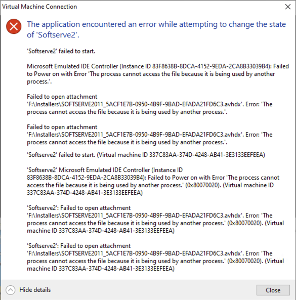

Now on the Win10 Host machine, I created a Gen 1 VM in HyperV, selected the existing VHDX file, and attempted to boot the VM, but I got the following error:

Here's the OCRed text from the error messages, so that it gets picked up by search engines:
The application encountered an error while attempting to change the state of 'Softserve2'.
'Softserve2' failed to start.
Microsoft Emulated IDE Controller (Instance DI 83F8638B-8DCA-4152-9EDA-2CA8B33039B4): Failed to Power on with Error 'The process cannot access the file because it is being used by another process.'
Failed to open attachment 'F.:\Installers\SOFTSERVE2011_5ACF1E7B-0950-4B9F-9BAD-EFADA21FD6C3.avhdx'. Error: 'The
process cannot access the file because it si being used by another process.'
process cannot access the file because it si being used by another process.'.
'Softserve2' failed to start. (Virtual machine DI 337C83AA-374D-4248-AB41-33133EEFEEA)
"Softserve2' Microsoft Emulated IDE Controller (Instance ID 83F8638B-8DCA-4152-9EDA-2CA8B33039B4): Failed to Power on with Error 'The process cannot
access the file because it is being used by another process.' (0x80070020). (Virtual machine DI 337C83AA-374D-4248-AB41-3E3133EEFEEA)
'Softserve2': Failed to open attachment 'F:lnstallers\SOFTSERVE2011_5ACF1E7B-0950-4B9F-9BAD-EFADA21FD6C3.avhdx'.Error:'The
process cannot access the file because it is being used by another process.' (Ox80070020). (Virtual machine DI 337C83AA-374D-4248-AB41-33133EEFEEA)
'F:\Installers\SOFTSERVE2011_5ACF1E7B-0950-4B9F-9BAD-EFADA21FD6C3.avhdx'. Error: 'The process cannot access the file because it is being used by another process.' (0x80070020). (Virtual machine DI 337C83AA-374D-4248-AB41-33133EEFEEA)
The disk image isn't initialized, contains partitions that aren't recognizable, or contains volumes that haven't been assigned drive letters. Please use the Disk Management snap-in to make sure that the disk, partitions, and volumes are in a usable state.

Make sure to have the VM shut down and have no snapshots associated with it.
Try converting individual disks and recreating the VM.
Could you please elaborate on what is that process that holding the VM?

yaroslav (staff) wrote:Make sure to have the VM shut down and have no snapshots associated with it.
Hi Yaroslav,
Thanks for looking into this. I've tried this now with two different physical servers running Server 2008 R2 ("Pulserver" and "Softserve2011)), and both fail, but in different ways.
I can't shut them down, because they're in production, but P2V is doing the conversion from a snapshot/shadow copy, right?
So there is no VM for the original, because they're physical servers.
I am attempting to use the created VHDX files in new VMs created in HyperV on a Windows 10 Pro box named HyperVTest.
I just tried converting a different physical Windows 10 box (Prod5) to a VHDX, and when I moved that VHDX over to HyperVTest and created a new VM with that VHDX, and it worked flawlessly.
But the same procedure is not working when attempting P2V on DC1 and DC2.
When attempting to convert DC2 to a VHDX, the resulting VHDX cannot be mounted on HyperVTest, and attempting to use it in a VM on HyperVTest results in the errors that I screen capped in my first post.
When attempting to convert DC1 to a VHDX, the resulting VHDX _can_ be mounted on HyperVTest, but when I attempt to boot a new VM on HyperVTest using it, it fails to boot. If I boot this same VM from a Win10 recovery flash drive and enter the Windows Recovery Environment with a command prompt, I can see the drive, containing a \Windows directory, but I can't get it to boot. I even tried running bcdboot.exe C:\Windows, which reported success, but it still won't boot.
I've tried to P2V on Disk0, on Volume C: (the original Windows volume), and on C: and E: (the original System Reserved) volume, but no method allows me to boot.
No, you need to have snapshots merged.
Do you have any checkpoints for this VM?
