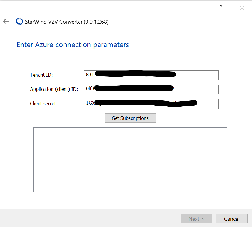

I have a problem with the StarWind V2V Converter.
I get no access to our Azure account.
I click on "Get Subscriptions" but nothing happens.
If I change any of the IDs or secret there is a error message shown, but with everything entered correctly, just nothing happens..
See the attached screenshot.
I set up everything yesterday and it did not work, I wait for today, but still nothing happens.
Could you please assist?
Kind regards from Germany,
Patrick

Hi yaroslav,
It is.
I want to convert an Azure virtual machine to on-prem VMware vSphere 7.
The resource group is there, the virtual machines are there.
Subscription pay-as-you-go is there.
Shouldn't there be at least an error message what's missing or wrong?

The strange thing is that old credentials (they were always working for me, to be honest) were working on Windows 11 PC to convert a local VM to Azure.
Tue May 16, 2023 8:41 pm
Found it. The issue relates to subscriptions. Make sure you are using Pay-As-You-Go (i.e., something that is not Free).
In other words, this seems to be something on Azure side.
