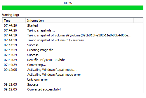

I am experiencing this error when converting a DISK to VHDX.
It is a Windows Server 2012R2 with the latest updates.

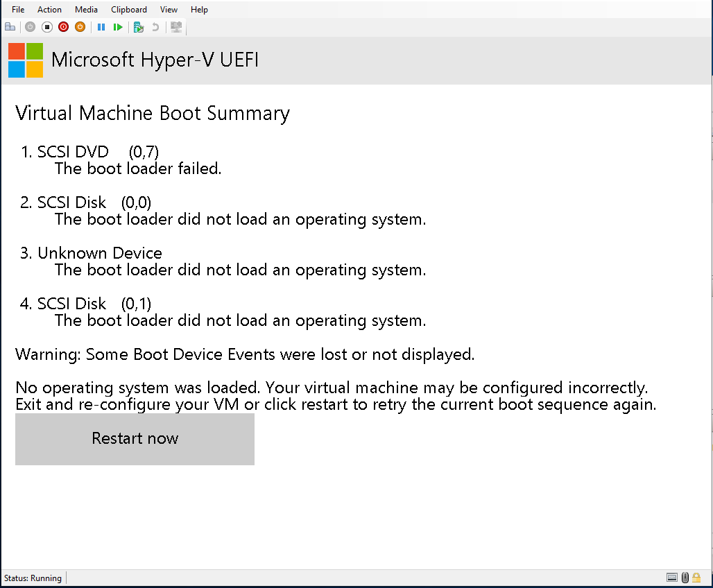

I have ignored the error and attempted to attached it to a Hyper-V VM,
but are unable to boot, Hyper-V reporting that there is no bootable OS found.
I have run out of ideas and have broken three converted files attempting to make it bootable.
It appears there is no RAW boot partition.
How should the Hyper-V VM be configured or what else should I do?

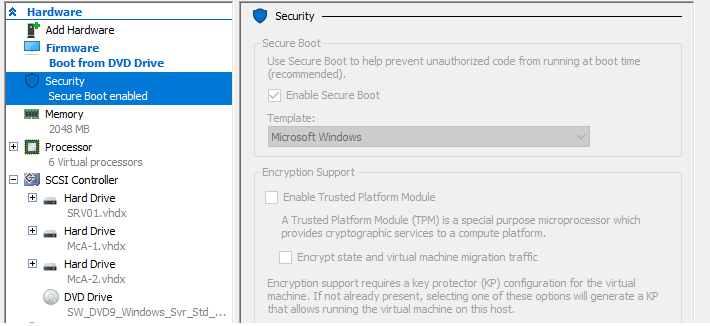

Current VM config
Current VM config

StarWind Error.
StarWind Error.

Mon Nov 22, 2021 10:59 am
You are booting the VM from the DVD disk.

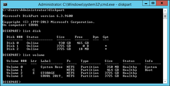

1. It is a physical server: Windows Server 2012R2
2. I wish to virtualize it to Windows 2019 Hyper-V Server
3. I have attached the Server 2012R2 ISO to the VM to use the command prompt utilities if required.
3. The physical server disk info as per image.
Physical Server 2012R2 disk info

Any idea why the Starwind report the error as in this screenshot?
