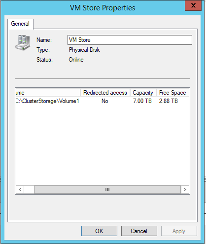

Fri Apr 02, 2021 12:54 pm
Looks like that datastore or the folder has a non-ASCI symbol. Please consider renaming the datastore.
mwalters@asbury.org
Joined: Tue Mar 30, 2021 3:05 am
Fri Apr 02, 2021 3:02 pm
Here are screenshots of the volumes
VM Store Label.PNG (11.37 KiB) Viewed 14894 times
Cluster Storage Volume Name.PNG (5.05 KiB) Viewed 14894 times
